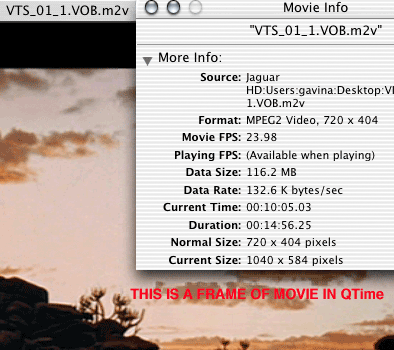

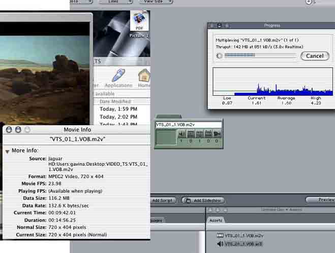

I did a small test with 2001. With DVD2oneX I set the User defined to 1028MB. I processed about the first 7 min of the movie. Then split the VOB file to m2v and AC3. Then put them into DSP. Made a DVD with the test. The output is still amazing, looks still as good as the master on the TV. Just have to test with 4 movies now on 1 DVD.

i doubt the quality is that good.. what you're saying is basically re-encoding at VCD bitrate (1024 / 90 minutes = 11.38 MB per minute bitrate - VCD bitrate is 10 MB per minute.)
if you're happy with VCD quality, fine.. i wouldn't recommend this though. what resolution are you encoding at? VCD resolution would be acceptable for this bitrate, but if you're using 740 x 480 the picture will look awful.

Its at 740 x 480. It looks amazing. Just do a test for your self. You can see the settings on the pic I posted in the Movie Info on QuickTime.
Its repeating on the TV right now
This pic says it all
Well I just finished 2001 in DVD2oneX at 1023MB and the final file sice came to 1.8GB for a 2 1/2 movie. The best bet is to set the Output to about 2200MB and just go with 2 or 3 short movies on a DVD.
