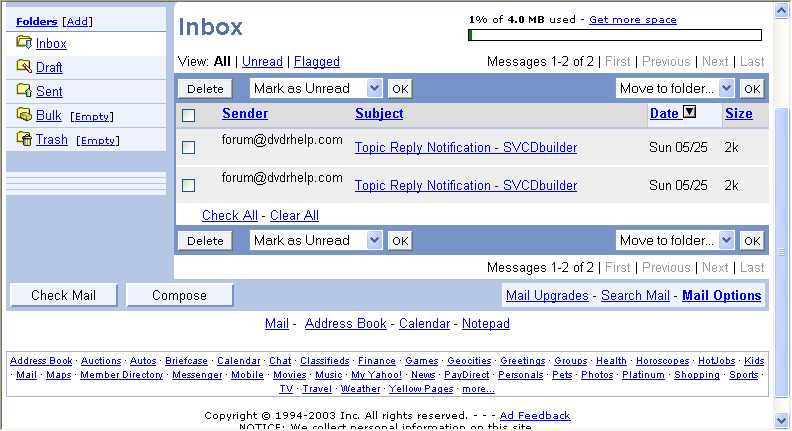

    Cecilio, the e-mails I've sent you returned. Maybe, they are too big?(3MB). I sent you a link to my Yahoo Briefcase, try to get the file from there.
    Michael
    Mar 2003
    Laredo,Tx
    no cause in my mail box i have 4 mb availiable. listen do you have msn messenger or yahoo messenger if so can you add me so i can just do this quickly cause seriously i feel like im getting no where
    An all in one guide for DVD to CVD/SVCD/DVD by cecilio click here--> https://www.videohelp.com/forum/userguides/167502.php
    Apr 2003
    Israel
    Cecilio, I sent the Briefcase link to cs2006_87@msn.com, check it, it must work. I'll try to send the file once more to both addresses. Tomorrow I'll try to find an additional place for alternative downloads.
    Michael
    Mar 2003
    Laredo,Tx
    hey migor i havent recieved any emails from you i checked my msn and yahoo every 30 minutes look do you have msn messenger if so add me
    ill be on and just send it to me there.
