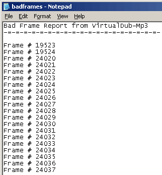

    Step 5: Browse to the contents of your C: drive with windows and open up the badframes.txt file.

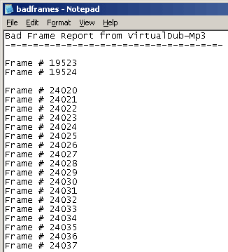

    Step 6: Find each set of non-consecutive numbers (ie: 1, 2, 3 are consecutive but 1, 3 are not) and put a carriage return everywhere the numbers are not consecutive. If there is more than one place in the file with bad frames, this procedure will split each set of bad frames into "chunks" that makes things easier to deal with later.

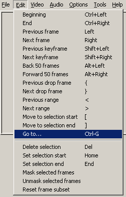

    Step 11: Push CTRL+G or click on "Edit" and "Go to…"
    Step 12: Type in the first number of a "bad frame chunk" that you made during Step 6 in "Jump to frame number" and push "OK"
    Step 13: Push the "Start offset" button (bolded left arrow button).
    Step 14: Push CTRL+G or click on "Edit" and "Go to…"
    Step 15: Type in the last number of the "bad frame chunk" that you're dealing with in "Jump to frame number" and push "OK"

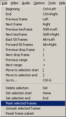

    Step 17: Click "Edit" and then "Mask selected frames."
    Step 18: Repeat Steps 11-18 for each "bad frame chunk" that you made in Step 6.
