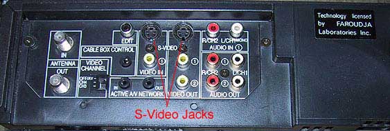

Using S-video output will give better results than using composite when capturing from VHS?Originally Posted by nwf_snake -
Hardrock:
S-Video "should" give a higher quality output than a composite signal. If you have both S-Video output on your VCR and S-Video input on your capture card, than by all means use it.
I personally tried S-Video on my setup and "I" could not see a significant difference. Furthermore the only VCR I have with S-Video output flashes to the screen a "Video Calibration" label when the auto-tracking kicks in to adjust the video clarity. Unfortunately this gets recorded. So, instead I am using another VCR with composite output that allows for manual tracking (that I can set ahead of time) and does not put a "label" on the screen.

S-Video on a VCR for 13 years. Now thats a hard one to believe. Maybe you should go out and try to buy a new VCR with S-Video. Don't think you-ll find one. And I'm not in Kansas - Missouri so show me fat lip. One thing I can't stand is someone who first lies and then tells another lie to cover the first. I would sugget to you to first understand the difference between an s-video connector and the one on your 13 year old system. better yet take a picture of it and post it. Maybe you should learn the history of s-video and when it came out on consumer products. And finally I spent 22 years in the Air Force all over including Japan, PI and South Korea. So yes I have been out of Missouri. Small brain!
Wow...Originally Posted by jdizzy40
I don't think he meant anything by it. I'm not taking sides but I don't believe the connector on a SVHS vcr is any differnt from any other S-video connector. BUT, I do not own one so I may be wrong. I do know that s-video has been around a while and I did see a svhs vcr at best buy the other day. Good to see you spent time in the service. I assume you were at Misawa (where I'm going).
Please someone who haves a VCR with S-video and composite line-out post a shot from a VHS using each on connection!
I have 2 Mitsubishi VCR's, both of which have S-Video output. At the minimum, svhs vcr's have been avilable for 4-5 years.

1) S-video and SVHS have been around since at least 1989, when I worked at a Circuit City. That's 14 years.
2) Hypothetically, an s-vid connection should be better, but with regular VHS it usually isn't visibly so in reality, thus manufacturers don't waste the money on them for regular VHS machines.

I've never seen s-video on regular VHS. Thats usually for S-VHS video, thats existed for more than a decade now. I'd also avoid Panasonic and Sony SVHS machines. The filters, if any, do not work as well as the ones in the JVC machines. JVC invented VHS in 1976 and S-VHS in 1987, and the machines do quite well, better than the others, and at half the price sometimes. JVC = Victor Company of Japan. (FYI: Do not buy a JVC 2000-5000 SVHS VCR expecting quality. Those are junk. Get 7000-9000 versions with all the goodies.)
Capturing to AVI is a waste of time if you just convert VHS. The difference in MPEG2 capture quality and AVI is negligent when your source is ONLY VHS. Others will argue, and I let them. It's their extra time, not mine. The AVI process will take much longer, require more HD, and not make much difference in the end. == If you want to RESTORE or hardcore EDIT, then consider the AVI format and using TMPGenc or Premiere (and encode with MainConcept).I'm not online anymore. Ask BALDRICK, LORDSMURF or SATSTORM for help. PM's are ignored. -
Panasonic and JVC are the same company. S-VHS has been sold in Northern Ireland since 1988. If you only have a standard VHS tape, outputting it throught the S Video connector won't make any real dufference as the signal is composite to begin with. It's only with the split Y-C signals that the difference becomes apparent.
Many VCRs and Satellite receivers, state "S-VHS" and not "S-Video", but it is the same thing.
The story is like this: When SVHS VCRs turned "mainstream" in the european market (early 90s), the S-Video connector appeared on various high tech/end Video equipment. It is the only signal beyond Composite the VCRs understand.
But because many people are stupid around the world, some companies (with British and American market knowledge), decided to name the S-Video Connector as S-VHS connector, just to point to the users that this connection if for their new S-VHS VCRs. That somehow continues untill today on many equipment.

SatStorm is correct in explaining that S-video connectors & S-VHS are both referring to the same type of connectors. I have worked for a high end A/V store for 15 years and have seen S-Video since it first came out on S-VHS VCR's and on Laser Disc players. Basically all an S-Video jack does is keep the Color & B/W signals separate. Where as in a composite jack the signals are combined. Below I have a picture the back of my Mitsubishi HS-U69 S-VHS VCR (This unit cost me $600.00). You can clearly see the S-Video Jacks marked.
