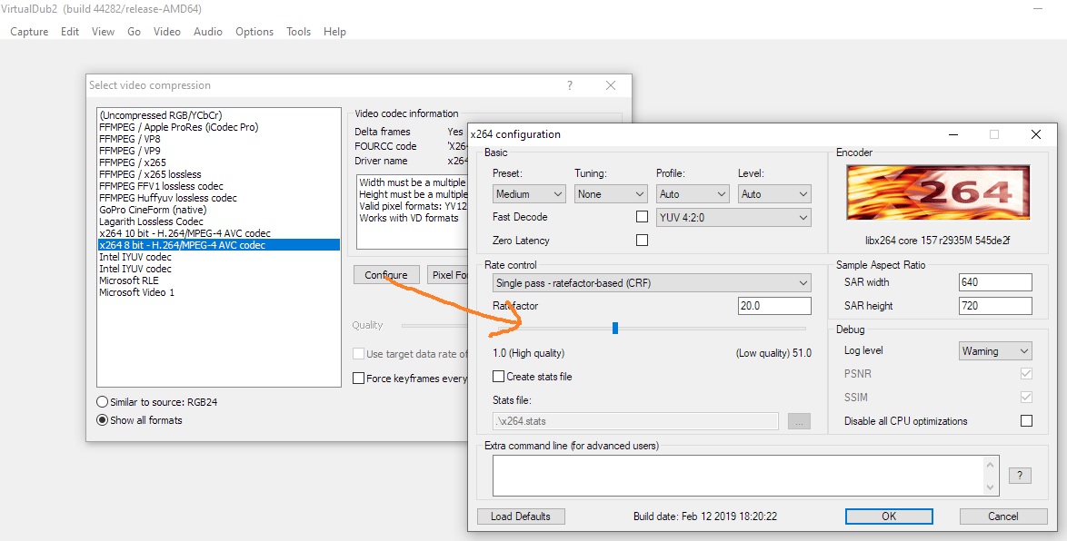

    Try vdub2, but do not use x264vfw, set video/compression to x264 8-bit
    Open up the configure screen and select "load defaults" (lower left)

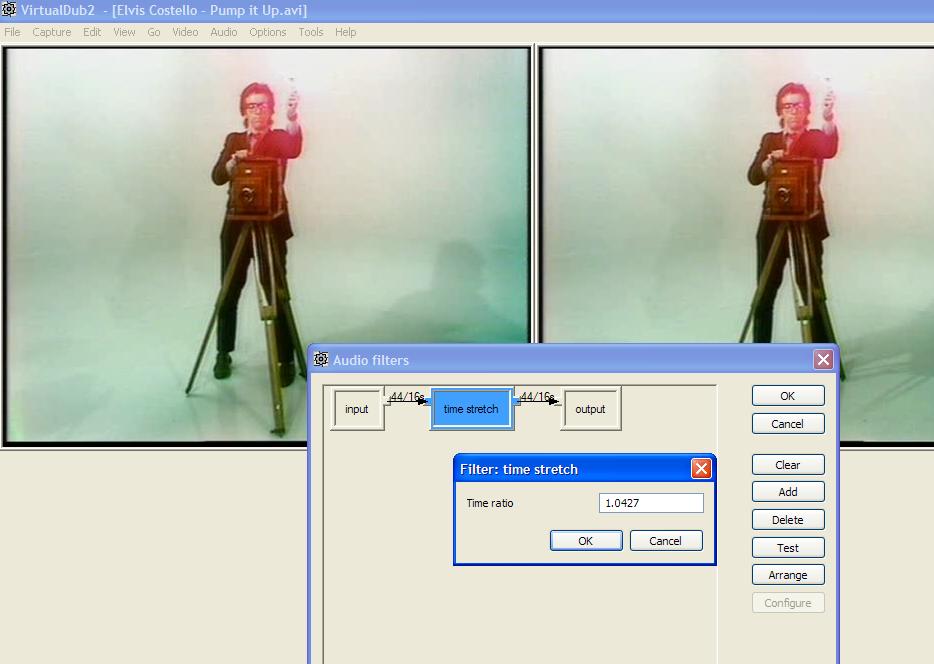

    Here's a music video clip, 25>23.976 conversion in vdub2, using video compression / x264 8bit and
    Audio/use advanced filtering/filters/Time stretch

    Good point - but it doesn't make a difference except for the time stretch "factor",
    23.976/25 = 0.959

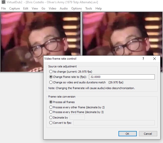

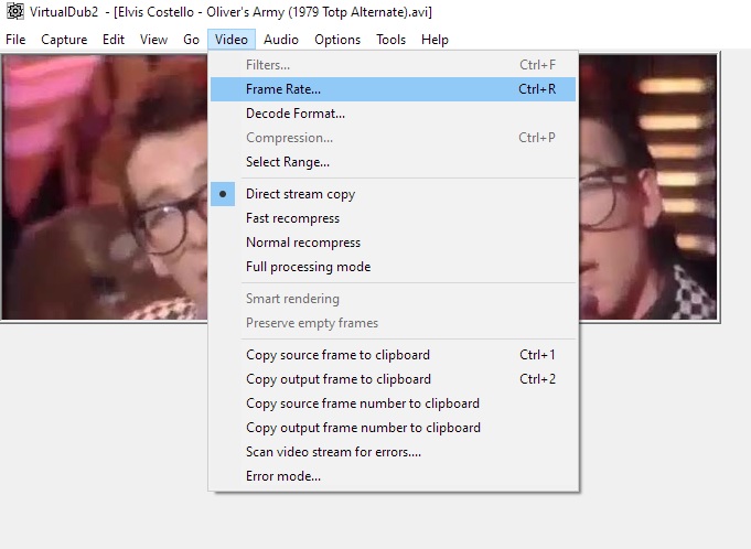

    If you're talling about this, it neither interpolates nor decimates to get the new frame rate,
    it just retimes the existing frames, causing the new video to run fast or slower -
    this is why I talked about having to stretch the audio to sync properly. (Similar to Assumefps(xx) in Avisynth )
    It's always done this, both vdub2 and the original virtualdub

    Who said anything about "change frame rate"? This is only when you want to slow down or speedup a video, or when the frame rate taken from the video file is not the actual frame rate. In all my posts I clearly used the word "convert". I want to convert the video frame rate from 60fps or 23.976fps or whatever that is to 25fps. This is the last option in the photo, look carefully. Just leave Source rate adjustment to "no change" and at Frame rate conversion select Convert to and type the target frame rate. My complain is the that VirtualDub 2 does a lousy job while the original VirtualDub does a perfect flawless seamless conversion. Why did they change the fps conversion method? Is there any setting or Registry hack or patch or filter or whatever else to get back the good old method of the original VirtualDub? I am afraid not, but hope dies last as they say.
  12. It has always been the case that VirtualDub(2)'s "Frame Rate Conversion" simply duplicates or decimates frames to achieve the new frame rate. That does not change the runtime of the video so there's no need to adjust the length of the audio. And the duplication or decimation creates little jerks in the video. "Source Rate Adjustment" just changes the timing of the existing frames, changing the runtime of the video, introducing no jerks, but requiring adjustment of the audio.
    If you're finding something different it's probably caused by the source filter -- some source filters have problems with some sources. Make sure you're using the same source filter.
