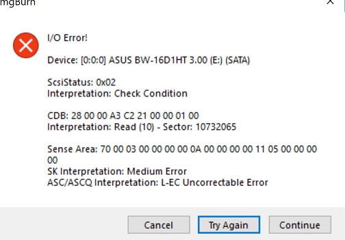

    Jun 2018
    Australia
    [Attachment 46009 - Click to enlarge]
    this is what i got from my burn anyone help. please
    dave
