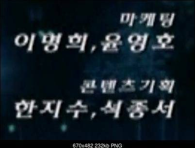

  1. Well... Some reason, when I convert 480i source to 1080i in Premiere Pro, this happens. (Click to see original image, because preview image is worse resolution than original, so you couldn't see same phenomenon in preview.)
    This is originally 480i Cable TV TS Capture, but I resized to 1080i using Premiere Pro.
    and most of TV Channel in South Korea also have this problem after late 2023~2024.
    This is original 1080i TV Broadcasting.
    but, if I convert it to 480i again, it does not seem to original quality.
    I thougnt It would be better deinterlace filter, but when I used QTGMC, it seems just the same using Bob filter.
    How can I convert it to original quality or similar?
    I couldn't found the way, except keep resize untill it seems good and use QTGMC... but it isn't perfect way.
    I want to get 480i video that looking just same as original 480i source, not the progressive video.
    Could anyone tell me what's the problem, and how can I recover it to original quality?

  4. I know after I resize video and use QTGMC, It's quality is much better then before. but it is not I really want. I want to get clean 480i source.

    I think I chose wrong thread title, What I really want is "Convert 1080i video (that weirdly resized 480i video) to most likely to 480i source". not 480p, because I can get better 480p video by using QTGMC.
    To better help, I attached original 480i source video, and video that weirdly converted original 480i video to 1080i by me.
    It is not same as korean TV Channels do because I'm not employee of Broadcasting Company, but I think it is similar condition.
    I know It's hard challenge, but I really want to resolve this problem strongly.

    Even without other operations, and you disregard lossy compression, upscaling then downscaling , is a lossy process unless you use nearest neighbor scaling on powers of 2. The "source" examples definitely did not, so you will never get similar to REAL original source on fine detail, such as small text. Perhaps you can train an AI to recreate those in the future, but there is no conventional way to fix those details
  10. If you look at the 1st post examples of the credits /text e.g. "2 - 투니버스_20250809_235546.ts" , both fields are missing data on static text. There is no conventional way to fix that properly. Maybe some anime folks trained some AI , I'm not up to date on that
