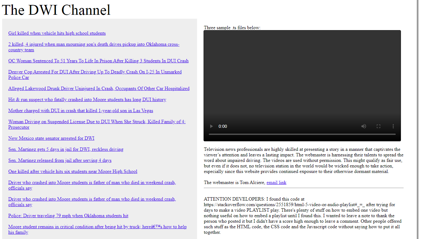

here's what i see on the test.html. the video won't play.
[Attachment 54227 - Click to enlarge]
Re: Make playlist play in browser's native player
IE reported "Unsupported video type"
Firefox reported "No video with supported format or MIME type found"
Chrome just has an empty player screen
I do not have a clue why these should work in Safari.

The mov files were playing in Firefox earlier. But the TS file that's at the start of the list now doesn't play. Why don't you just remux all your videos into a supported container? Here's a batch file to remux to mp4 with ffmpeg (drag/drop a video onto it):
ffmpeg" -fflags +genpts -i "%~1" -c copy "%~dpn1.mp4"
An mp4 with the same base name will be created in the same folder as the original video.

I've been monitoring this idio...err....clow...err...person's 'planned to be bigger than the Weather Channel's' website and his latest update is beyond anything I've ever seen before!
He claims to have gotten permission to use clips from a single news channel, but for the past month or so, all the clips linked to and hosted on his site have been 404.
His latest update now has HTML code that you have to: "To include more videos, copy the code below and paste it into a blank TextEdit (Mac) or Notepad (Windows) and save the file as playlist.html and then play it on your browser.
I haven't figured out how to make the playlist skip absent videos, or loop yet."
And includes the disclaimer "You put this HTML page on your computer. You are responsible for copyright compliance. Now play the video playlist, streaming the videos from their owners’ websites."
Get's better! On the homepage he writes to the TV Stations:
"TV Stations:
Of course, there are things you can do on your end to prevent your server from delivering the videos in the above playlist, if you want to be like that. Just remember that the teenager who is told to watch the playlist before borrowing the car on prom night could crash into somebody you like. Your TV station can pay with bandwidth or innocent persons can pay with blood. You decide.
If you don’t want to pay for the bandwidth then give me permission to host your video on https://dwichannel.com <email link deleted>" :adminfinger::onfire:
Too much fun!!!:D:stupid:

Well, I made some more changes. The vast majority of the TV stations refrained from replying. I cannot show their videos on The DWI Channel but end-users can put the playlist on their computer. They can copy and paste the code (Which has the left angle brackets "<" converted to HTML code, & lt ; ) into TextEdit and save it as an HTML page. To see how it works, the High School Edition is more brief. End-users can also select clips from https://dwichannel.com/playlist.txt
I still need some help. The first order of business is to have a playlist the end-user can copy and paste that skips absent videos instead of crashing. The second priority is to make the playlist loop. Sadly, there is no shortage of horror stories but eventually the player reaches the end.
The playlist would still have to be copyable.
When TEGNA provided a licensing request form, it mentioned that they wouldn't license anything with one of their employees in it. Since that is critical to the mission of The DWI Channel I asked, what if the employee gave permission, and I got this explanation:
We are unable to allow use of any TEGNA employees including anchors or reporters from the station. While I certainly appreciate that this material adds context to the narrative of your project, it simply isn’t something that is possible to license. Our news stations and news employees must maintain the highest level of journalistic integrity. They select and produce news stories from a standpoint of public good and viewer advocacy. To take material produced in that vein and use it in a commercial setting changes the dynamic of the content in a way that doesn’t feel right. I have no doubt that your project has nothing but the best of intentions. News media outlets have found themselves in an odd place these days. The entire industry has an image problem. Here at TEGNA media we have the ethical responsibility to stick to our standards despite what the rest of the industry is doing.
