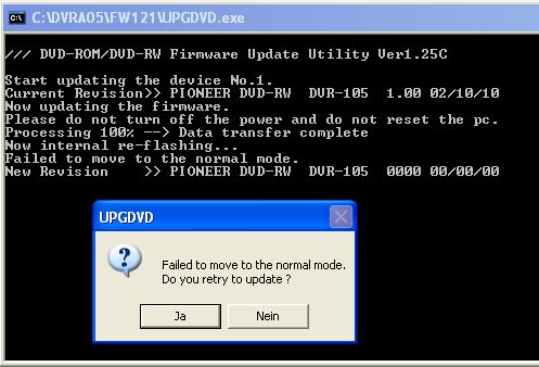

Have ASPI 4.60 and Pioneer A05. My problem is i'm not able to upgrade 1.00 to 1.21 firmware. Please help!
https://www.videohelp.com/forum/images/guides/p477673/A05_121failure.jpg
I believe if you had any apps running that accessed the DVD-drive (like Nero InCD or Roxio DirectCD or even if an open folder) that could cause the drive to not accept the firmware upgrade? Look at your system tray to be sure (anti-virus could cause that as well)?
Also you ay want to take the drive out of DMA mode in device manager.Quote:
