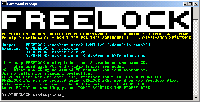

    1. You'll need to create an un-protected VCD/SVCD first, so do that in your favourite way.
    2. Then, open up CDRWin and create a .cue file from your un-protected disc, save it to C:
    3. Goto Command Prompt and type:
    A: (enter) FreeLock (enter).
    4. The usage of FreeLock is pretty basic. At the command line type:
    freelock c:\image.cue
    5. Finally you must burn your modified image.cue file onto CD.
    Remember to keep the FreeLock diskette in your A: drive.
    Note:- If CDRWin gives you an error at the end of burning your modified .cue file (99%-100%), ignore it the data will have already been written and the VCD/SVCD play perfectly.
    Done!http://[img]http://www.dvdrhelp.com/...898/[/img]

    Yes. Actually it is pretty easy. You can extract the non-dummy track with CDRWin. You could also use (but I've never tried) IsoBuster to extract the .mpg-file only.
    [Error-message:] start dao recording comand file on device 1:0:0 Cueshet was rejected by the CD-ROM recorder
    1. did you move/rename the .cue or .bin file?
    2. did you use spaces/special chars in the filenames?
    3. have you checked the .cue file (with a texteditor), if the name and path of the .bin file matches exactly?
    4. do you have a HP or Sony writer? If yes, check the freelock homepage for info

  8. It worked excellent for me mate
    There is a helpfile with the freelock that says i will not work on cdroms like vcd and svcd but i tried to extract the avseq01.dat av file to create a vcd with nero but the file could not be extracted to my HD with winME OS!!!!!!!
    Also the VCD plays fine on my Danansai1010 DVD player.
    Top marks mate
    Also the 4th step reads freelock c:image.cue and not freelock c:\image.cue on the main user guide page mate.
    Hope it helps JP
