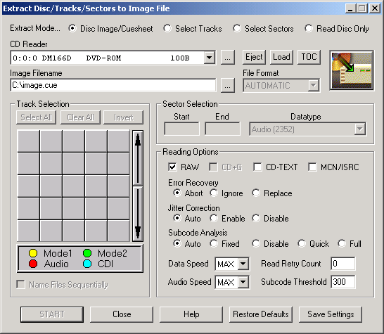

2. Then, enter CDRWin and create a .cue file from the un-protected VCD/SVCD you just burnt.

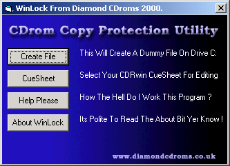

3. Open up WinLock and hit "Create File".
4. Then hit "Cuesheet", and locate the Cuesheet you created earlier.

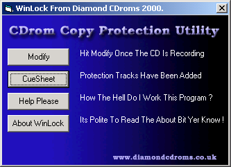

5. Keep WinLock open, and re-open CDRWin.
6. Once the CD has started Recording, click the "Modify button, this alters the dummy file and this is the key to the copy protection.
7. CDRWin will tell you that the Burning process has failed, but this fine because all the important data has been burnt already.
