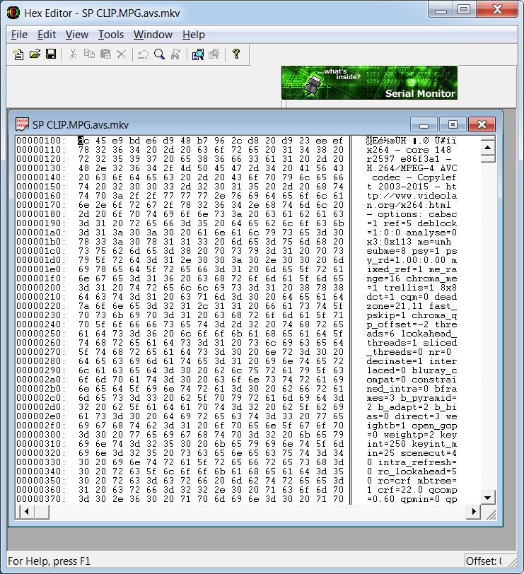

  4. MediaInfo can't be wrong on this report. All it's doing is displaying the plain text metadata that x264 writes to the file. Open the video in a hex editor and you'll see the text. A random x264 encoded video:
    [Attachment 39880 - Click to enlarge]

    Wow, no wonder... I knew something was different. Most interesting, thanks man!
    Good to know too about the hex editor; I always wondered if there was a way to examine the video stream and determine what encoding parameters were used (when hidden) Thank you too jagabo!
