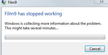

    My 3rd time installing/uninstalling/reinstalling latest version Film9/Net4.6 on W6/64 tonight. Get error message each time on opening exe - same issue as pauljames2 initially had: program crashes immediately with error message. Your assistance appreciated.

    Yes Giles, still same error.

    Please, Can you put a copy of the error message.
  26. Member
    Aug 2016
    LONDON U.K
    "Film9 has stopped working"

    It is difficult to say with certainty what is not working in your configuration.
    Here experience with the tracks to follow:
    - When we reinstall Film9, it is essential to erase all the programs necessary to Film9 (Film9, FrameWork 4.6, Avisynth, VirtualDub, Quicktime).
    - Delete Folder "F: Film9"
    - Delete Folder "C: Program Files (86) \ Film9 \ ...."
    - Delete Folder "C: \ Users \ Your session \ AppData \ Local \ Film9V2 \ ..."
    - To clean the registry with a cleaning program.
    And only once a clean computer to start step by step installation of Film9.
