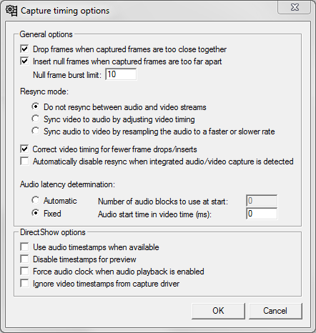

Just wanted to get a feel for the best VirtualDub sync settings. Looking over the rev. notes, it seems many of the options/features were designed with hardware limitations of the time in mind, but I am wondering if it is just better not to let VirtualDub resync anything at all.
What are your thoughts?

It is certainly better, if your hardware will do it without needing frames dropped/inserted to keep the video synched to audio.

This is how I set mine up, using in Avermedia PCIe capture card.
My settings are quite different (also using an AVerMedia PCIe card among others).
I would check the "Automatically disable" box, but I already have it manually disabled anyway and I'm apparently superstitious about messing with it when it seems to be working. I don't have any justification for setting latency to Fixed. Actually the more I look at it the more that looks wrong, but I played around with it 2 years ago and it isn't creating noticeable problems.
I found that when I unchecked the first two boxes, VDub would never drop/insert even when it was absolutely necessary to maintain sync (like if I decide to try capturing 720p60 with a slow x264vfw preset and my CPU is completely unable to compress the frames on time). The video track would just end up short.
