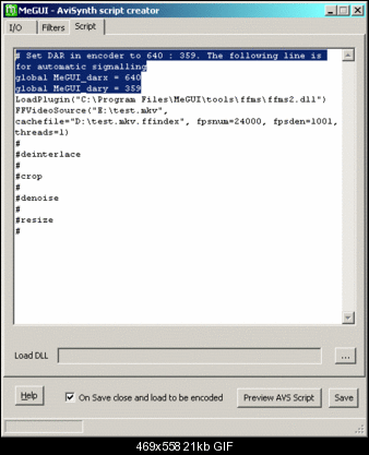

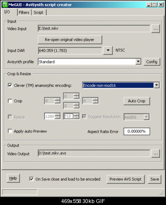

    As far as MeGUI goes, there's no need to input the SAR manually (leave it set to "default' in the x264 encoder configuration). Enable anamorphic encoding when creating a script and MeGUI will add the appropriate DAR to the top, which it'll later use for setting the SAR when encoding. As an example:

    Selecting the "encode non mod16" anamorphic encoding method will disable resizing. It doesn't mean the video will be non-mod16, just that it can be if the source is non-mod16.
    Add the encoding job to the queue after saving the script and MeGUI will take care of the SAR.

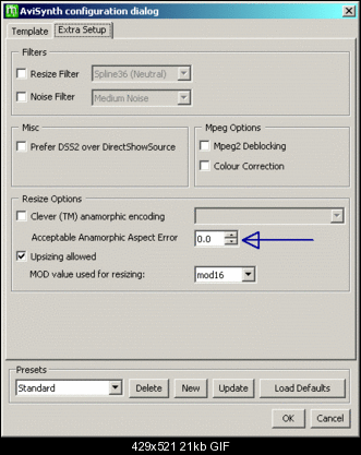

    MeGUI also has an aspect error setting hidden away in it's AVISynth Profile configuration. It only applies to MeGUI's anamorphic encoding and how much it's allowed to "fudge" the aspect ratio. It's set to 1% by default.

    To resize "freely" you might want to enable the ability to resize "up". I think having it disabled by default is silly, but you can enable it in the Avisynth profile configuration (pic 3, post #6).
