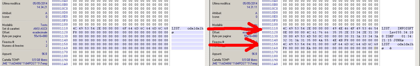

  4. thank you jagabo, so if I would like replace a block as this
    how should I do?
    is there a dos-command or a program that can auto-modify a .avi file?

  7. I can change .avi files with hex editor gui ecc.. but I need to batch automate the timecode writing in file, so I'm looking for a dos command line to simply replace a block of data as image attached
  8. You need to understand RIFF structure before you can make patches like that.
    http://msdn.microsoft.com/en-us/library/windows/desktop/dd318189%28v=vs.85%29.aspx
  9. I know that my procedure are not regular, but teorically if I want timecode I have to change virtualdub and this is not possible.
    I am not able to rewrite a version of virtualdub that do timecode as I want, and think nobody is able to do. Simply I just noticed that replacing bytes as show in attachement, my NLE have the timecode of the clip and and the clip are perfet playable. Analizing riff chink of the .avi file of course I get a "invalid chunk error" but this is not important when I can use clip with timecode in nle and all work ok.
    Being that I have no chance to rewrite virtualdub for my specific needs, I'm forced to find a way to change "manually" and automatically with a batch procedure, individual bytes and an entire block in the file .avi header
  10. If you really want to screw up your files like that search for binary patch utilities.

  13. Originally Posted by jagabo View Post
    yes, I'm looking for a partch utility but I in the string to replace I need to extract timecode from the source .mxf file and "stamp" into the .avi destination file
    It's not easy, but not impossibile

  15. I wrote a quick dirty program that can copy a block of data from one file to another, with the positions specified for each.
    AviMangler  source_file  destination_file  source_pos  length  destination_pos
    I hesitate to give you a copy because you're going to be messing up your files by doing this. The program has no error checking or reporting and I've only tested it on a few small files.
