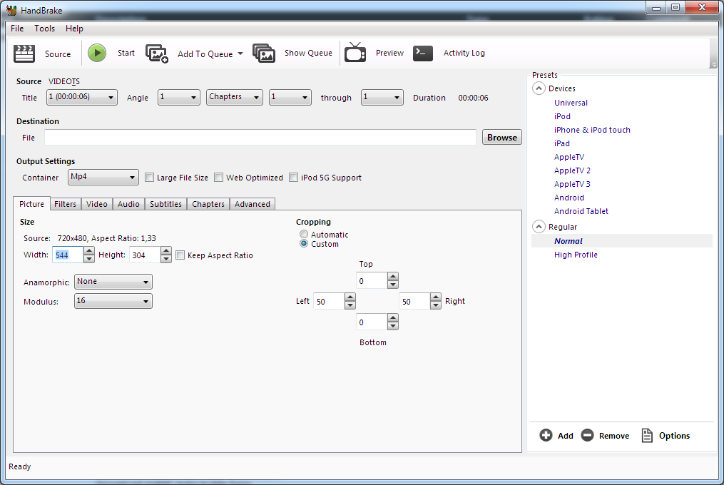

    You must crop it or zoom using your player. It wont help just changing the aspect ratio flags or just resizing.
    In for example handbrake can you crop under the picture tab. Crop for example 50 pixels left and 50 pixels right and you will get a size of 540x304 = 16:9
  3. Try remuxing with Yamb and setting the aspect ratio flags. That will be very fast and there will be no loss of quality. Or, if you can live with MKV instead of MP4, use MMG. Not all players will respect flagged aspect ratios though. And you'll have a distorted picture if the movie is really 2.1:1.
    Both methods works. It's just a matter what you like...distorted/stretched or cropped image.

  6. I'm a MEGA Super Moderator Baldrick's Avatar
    Something like:
