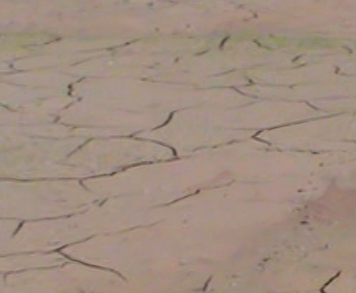

    I want to edit a video (change audio, add credits, apply some minor adjustments and stabilization), however, I would like to use as 'basis' the best possible quality. The source is a 720x576 mpeg2 video from a camcorder (PAL 25fps?, interlaced, pixel aspect of 1.4568* or 1.422̅2* so, the output would be 1049x576 or 1024x576). *-> different depending on the software
    I would like to upscale that to 720p.
    The problem is, for some reason beyond my understanding, no other software can achieve the quality of MPC-HC playback. I've downloaded trials of pretty much any editing software out there (vegas, the 2 from corel, avidemux, virtualdub, cyberlink, premiere, and others) and played extensively with the settings, as well as tried other video players (vlc, potplayer, windows media, mplayer (smplayer), mpv, quicktime) and none of them could achieve the quality of MPC-HC playback. I've tried neatvideo also.
    I'm almost sure MPC-HC applies some kind of filter to the video due the interlacing or perhaps the deinterlacer is just superior. Changing the setting didn't seem to have any effect and I couldn't find what's so special about MPC-HC.
    I'm attaching images showing the difference between MPC-HC and the others (including the video editors).
    I just want a way to reproduce the MPC-HC quality in a video editor (except premiere and expensive ones) so the output file will have decent quality. Perhaps there's a way to 'dump' the MPC-HC video in a 'raw' file or something, so I could just use virtualdub.
    Also, I don't understand why MPC-HC deinterlaces the video AND plays it at double framerate, because afaik it only should be played at twice the original framerate if you're discarding the other 'field' at every frame, so, you'll end up with two images for each original frame. So you either have both fields deinterlaced playing @ 25fps or you can just 'intersperse' them, so you have half the vertical resolution but twice the framerate, but it seems MPC-HC is actually managing to have both, and by analyzing frame-by-frame it's possible to see that it actually has higher resolution AND twice the framerate. It's quite crazy if you ask me. Quicktime for example displays a pixelated video @ 25fps, so, 3/4 of the 'data' is just being lost (one interpolation field and one frame (2 fields))... unless MCP-HC is applying some very smart twixtor-like frame interpolation what I really doubt.
    Perhaps the best solution would be an 'output' for MPC-HC that writes a lossless file to disk (1024x576 @ 50fps in this case), afaik VLC allows you to do that.
    Seriously, this is the first AND the last video I'm editing (that's why I want a 'free/cheapo' solution) this thing certainly is not for me. It's going to drive me crazy.
    Any help is appreciated.
    Thank you in advance.
    Image Attached Images

  10. I don't know which images are which in your screenshots.
    I still think you're wrong about MPC-HC v Yadif. I compared a video played using VLC and Yadifx2 with MPC-HC and they look virtually the same to me. Be careful you're comparing apples with apples. Screenshots may be deceptive because each de-interlaced frame mightn't be identical. I can stop MPC-HC and VLC on the same frames and the MPC-HC version will look better, but advance a frame or two and it's the reverse. It might depend which field is being de-interlaced as the first filed, but when actually playing the video the two methods seem to do a basically identical job to me.
    If you resize the video to compare them (ie run them fullscreen) the method used to resize can have a big effect on the straightness of straight lines too.
