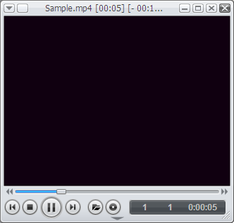

    sir, my windows player is updated and also jet-audio fails too..
    please check out the attached file..
    thanks again for your reply
    best regards

  6. I'm a MEGA Super Moderator Baldrick's Avatar
    Join Date: Aug 2000
    Location: Sweden
    Does other mp4 with h264 video work fine?
    Join Date: Dec 2006
    Location: Bangladesh
    yep
    others works fine with h264 codec but not mine
    thanks for your reply
    best regards
  8. I'm a MEGA Super Moderator Baldrick's Avatar
    Join Date: Aug 2000
    Location: Sweden
    Nope. No idea.
