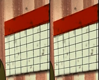

    Originally Posted by VideoFanatic View Post
    Yes I could try it myself but I can't always see what you guys can see which is why I'm asking what you guys think would be the best option for upscaling?
    Most videos won't show such and extreme difference, but here's an example from a frame enlarged 2x with Lanczos4Resize(width*2, height*2) on the left, nnedi3_rpow2(2) on the right:

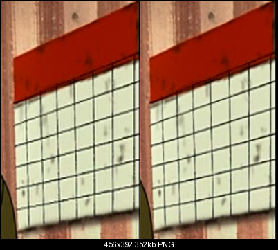

    It's less obvious with 512x384 to 720x480, but still visible:
    nnedi3 will give smoother lines and edges, sharper lines and edges, and less oversharpening halos.
  19. OK I see what you mean but what if you don't use Lanczos4Resize to double the resolution and instead just upscale from the original resolution to 704 x 480 with Lanczos4Resize? Could you please show me a pic of that compared to nnedi3_rpow2(2)?
    Join Date: Dec 2005
    Location: none
    That's what the second image pair shows.
