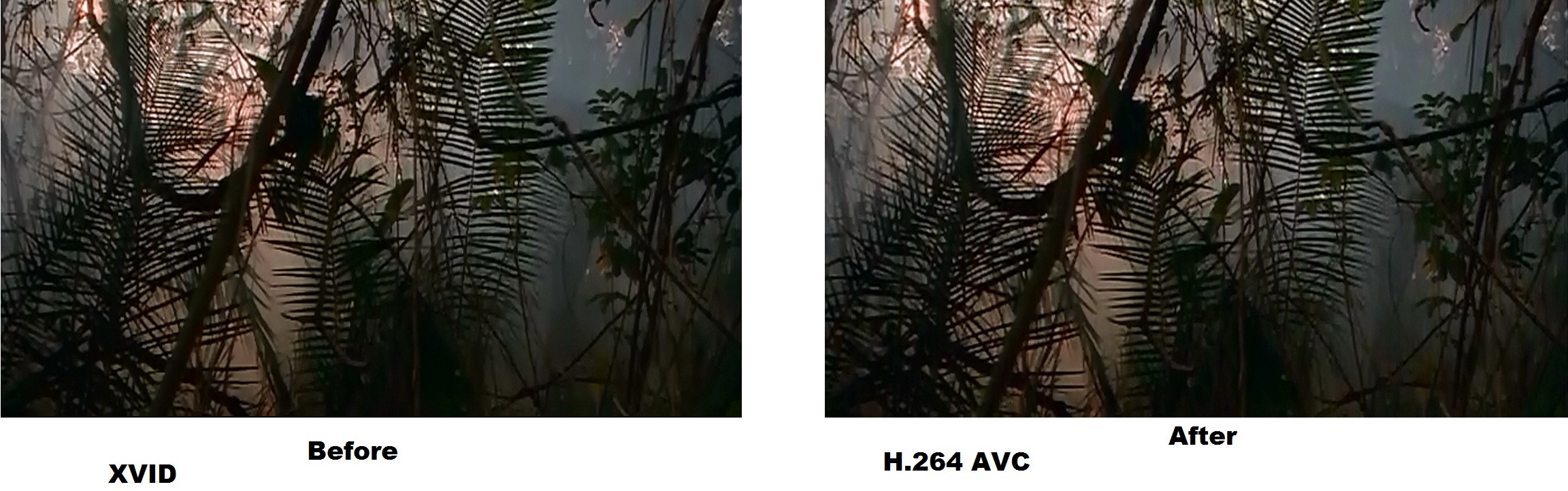

    Join Date: Feb 2013
    Location: Europe
    I believe it is indeed possible, here's a comparison pic of a movie i tried to re-encode today:
    Join Date: Feb 2013
    Location: Europe
    I believe it is indeed possible, here's a comparison pic of a movie i tried to encode today:
    http://i.imgur.com/nqUcxqL.jpg
  18. Theoretically it's impossible because encoders such as xvid and x264 are lossy, so the original image is always somehow changed, or information is lost,
    however at a high enough quality setting or bitrate any difference may be virtually impossible to see. Especially using the x264 encoder. Xvid doesn't
    encode as accurately. It'd be a bit like converting a CD track to MP3. At best, you're not going to be able to tell the difference, but it won't improve the
    audio as such.
    Having said that, if you encode a video while using filtering to purposely change it in the process, ie removing noise or applying sharpening, then the
    encoded version may look better to you (quality is very subjective) but it's really the filtering which altered it in a positive way, not the re-encoding. For
    instance I often encode DVDs while resizing them up to their correct aspect ratio and sometimes I think the fairly sharp resizing makes the encoded
    version look a little better than the original when running full screen on my TV, but then sometimes I don't.....
    I'll admit there's possibly been a few times when I've re-encoded video and even if I can't put my finger on it and say exactly why, I've thought the encoded
    version looked a little better, but maybe that's because it didn't encode some of the original noise as accurately, or it didn't reproduce any compression
    artefacts in the original video accurately, maybe "smoothing" it a little when re-encoding, but that'd definitely be the exception rather than the rule.
    As I said though, quality is a very subjective thing so I wouldn't argue with you if you say one version looks better to you than the other, but if the definition
    of quality is nothing but how accurately the encoder duplicates the original video, (which would probably be the definition of quality mainly used for describing
    video encoders around here) then yes it's impossible for it to "improve" the quality just by re-encoding it. At best, it'll appear to be exactly the same.
