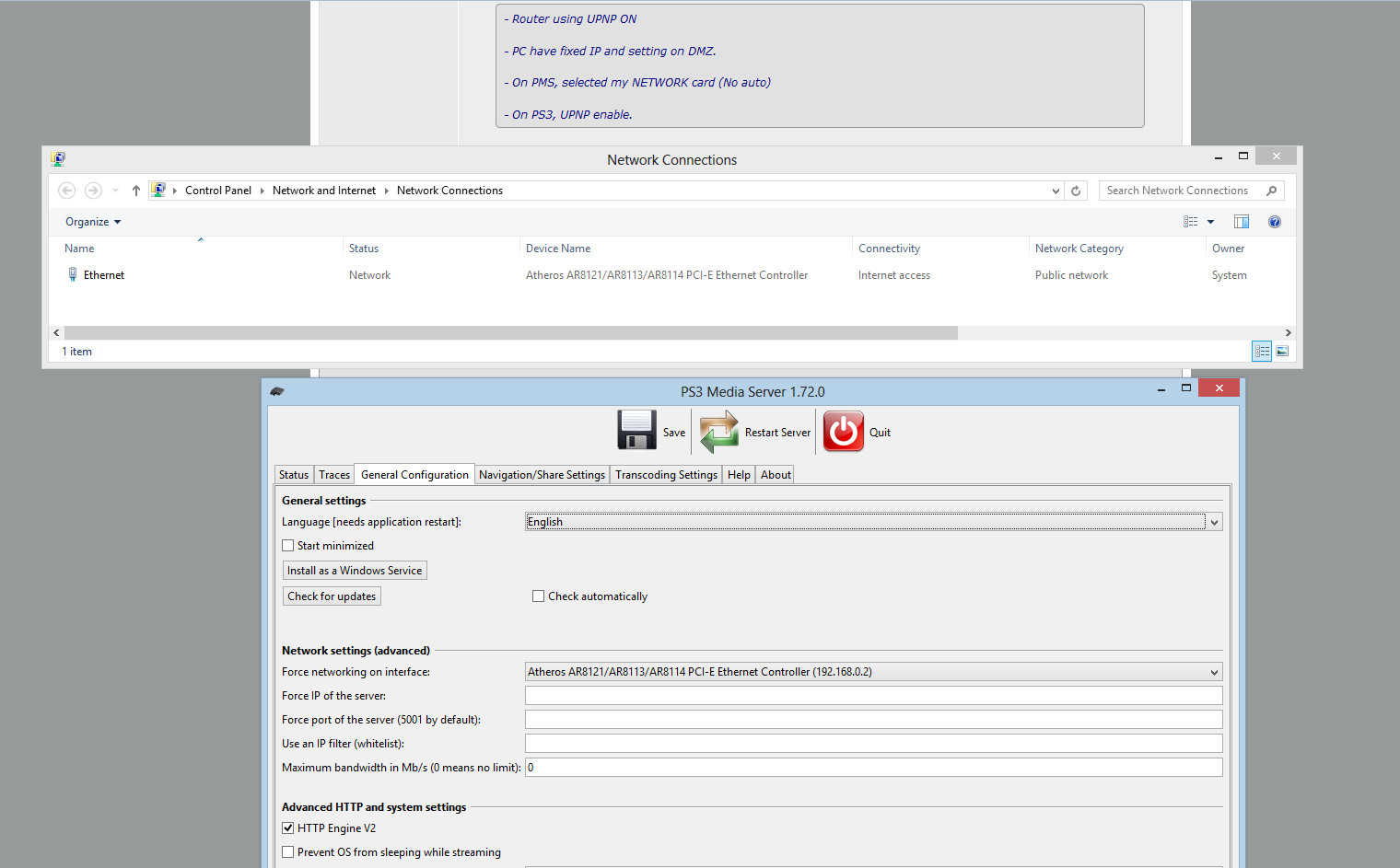

    My setup to PSM work:
    - Router using UPNP ON
    - PC have fixed IP and setting on DMZ.
    - On PMS, selected my NETWORK card (No auto)
    - On PS3, UPNP enable.
    Claudio
  15. network card is selected , sais the ip address and the network card in playstation media server
    i just auto click through on ps3 on network setup, whatever default security is and havent changed anything with my router...
