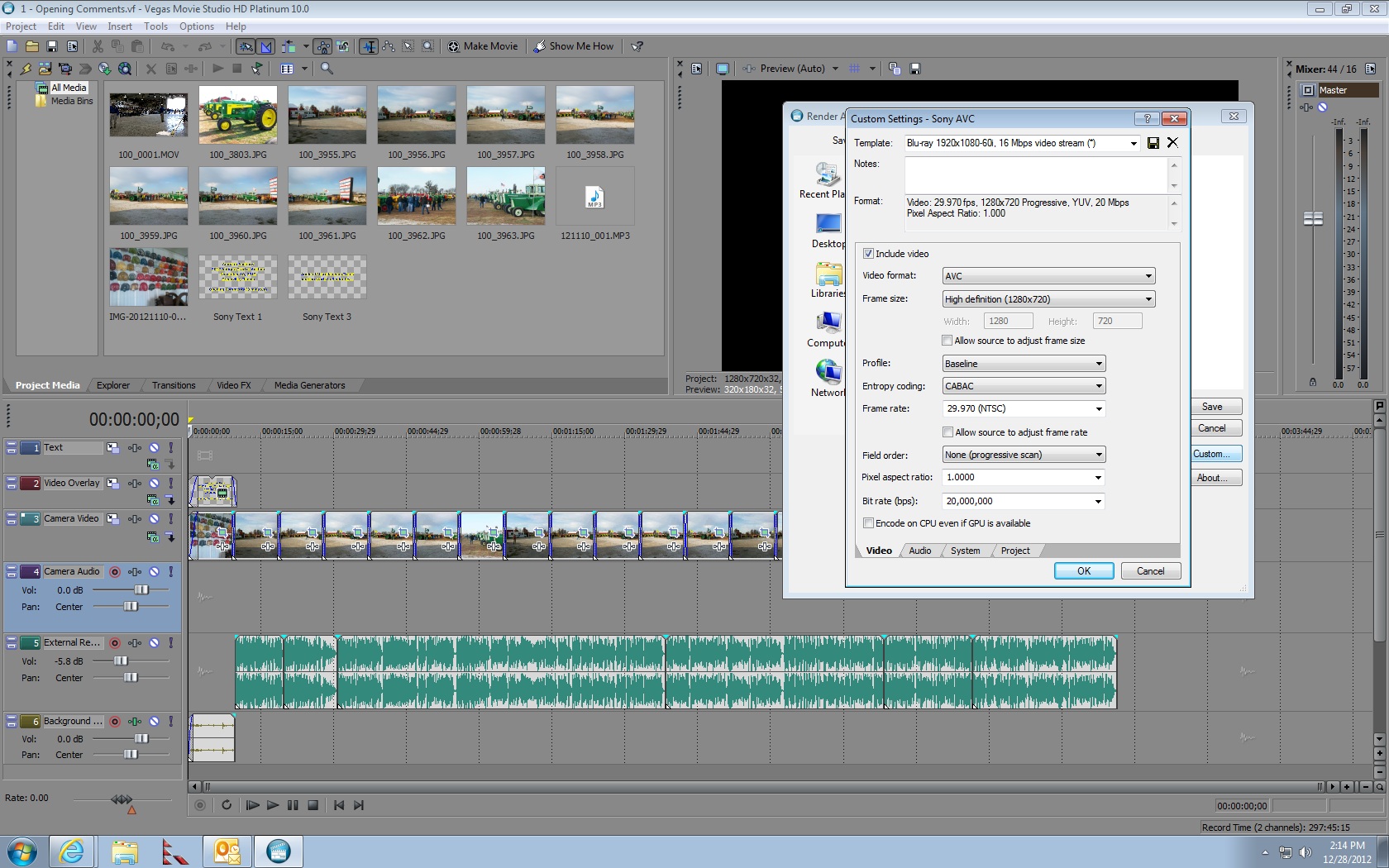

    My source files are from a Kodak Playsport, MOV extension, 720p at 59.94 fps. I have edited the videos in Vegas, and need to save them in AVC format for eventual burn to blu-ray. Intent is to keep source resolution and frame rate so that blu-ray video quality is as high as possible, and output file type that DVD Architect doesn't have to re-render. Unfortunately, Vegas doesn't offer anything but a "baseline" profile for the Sony AVC format, and for 720p this tops out at 29.97 fps. Is there a way to get Vegas to output a 720p 59.94 fps AVC file?
    Attached Thumbnails Click image for larger version
Name:	Vegas AVC Profile Screen.jpg

    in vegas pro you just type 59.94 in the box. no idea if it works in studio though.
    Join Date: Sep 2007
    Location: Canada
    Studio version probably has fewer options. If you can't access "high" profile, try mainconcept AVC instead of sony AVC
    I mentioned this in your other thread by sony has problems with making compatible blu-ray streams using AVC, they get re-encoded in DVDA (not only a waste of time re-rendering, but you incur quality loss)
    Another option would be to use debugmode frameserver and some gui for x264 (x264 will produce better compression & quality anyway) , or a lossless intermediate and x264

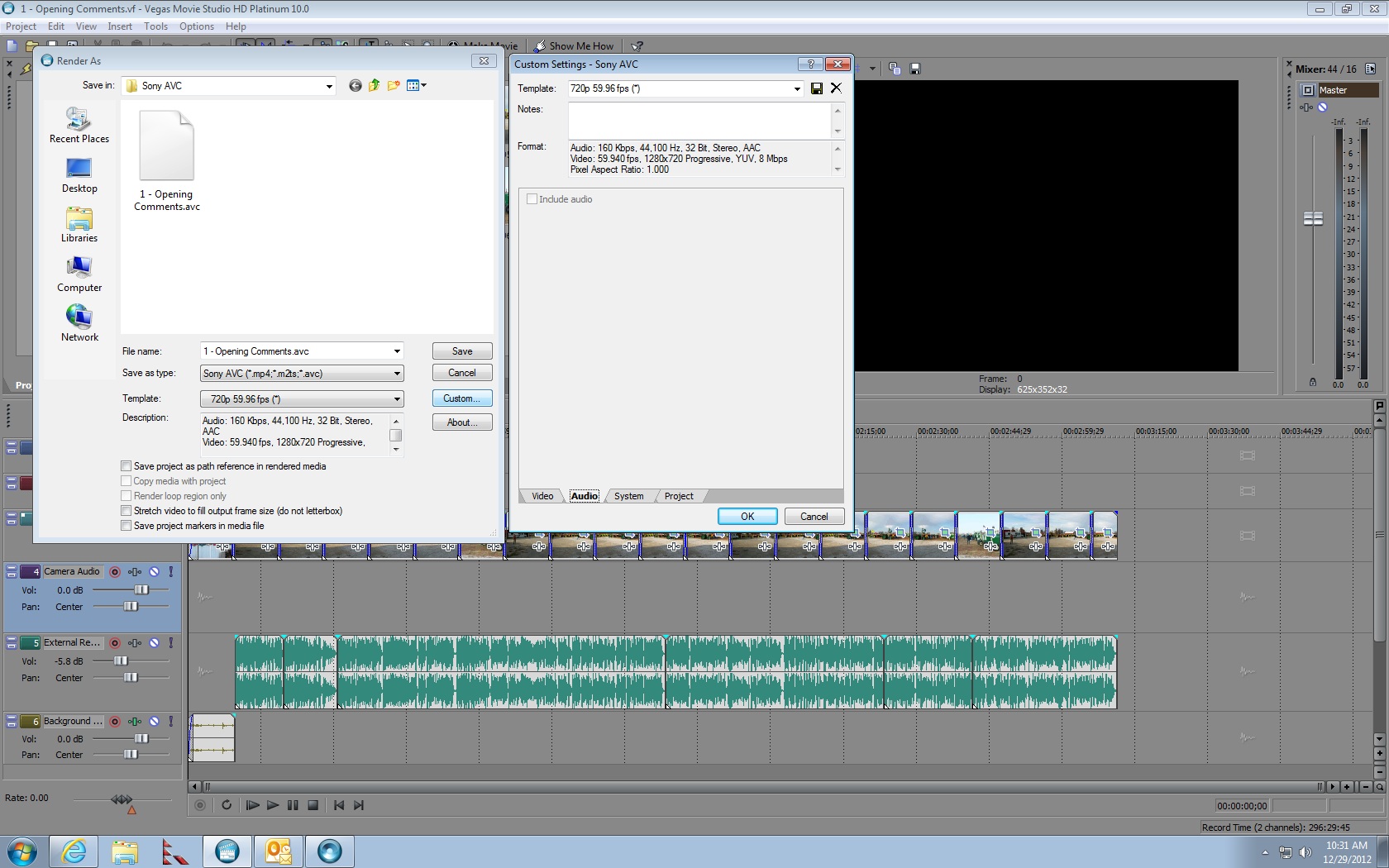

    The "Include Audio" option on the audio tab is greyed out. Seems like once AVC is chosen as the file extension, it prevents audio from being included.

    create a new template, checkmark "include audio" in the audio tab
    If I use the existing Sony AVC template and choose AVC as the format, the include audio option is greyed out. Is there another way to create an AVC template that includes audio? Or, given what you've said about the shortcomings of the Sony AVC template, would I be better off rendering using Main Concept AVC, knowing that the video will be re-rendered in DVD Architect? My goal was to render in a format that didn't require re-rendering in DVDA so that video quality stayed as high as possible after the initial render. Seems simple, but so far impossible to achieve...
    I have the feeling I'm clearly documenting my own ignorance in my posts...thank you for putting up with my lack of knowledge!
