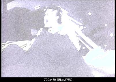

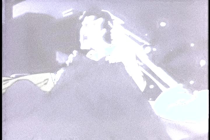

    So I added "off_y=-180" to subtract 180 from all the Y values:
    I got these values largely by experimentation.

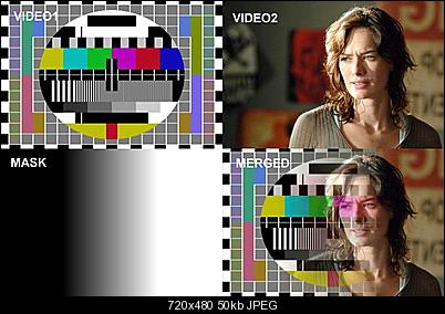

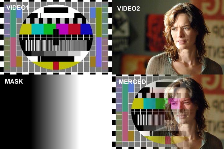

    When using an alpha mask in mt_merge() the black (Y=0) parts of the mask will show only the first video, the white parts (Y=255) will show only the second video, shades in between will give a weighted blend the two videos. So if Y=25 you get a blend of about 90 percent the first video, 10 percent the second. With Y=128 you get 50:50 mix. With Y=230 you get about 10 percent the first video, 90 percent the second. An obvious example:
