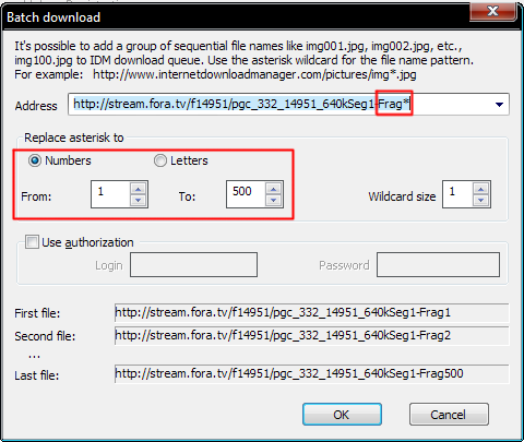

  16. You'll need to see HTTP traffic you could use Url Snooper or CooJah but I use Firefox like this -
    1. Close and reopen Firefox.
    2. Open Web Developer Console by going to Tools > Web developer > Web console. Close all tabs on left except for Net. Set filter (right hand side box) for seg1-frag1 for first fragment or .f4m for manifest.
    3. Enter URL of your video in Firefox address bar and press go.
    4. Click on URL displayed. In "Network Request" box highlight URL, press Ctrl+C and paste URL into Script or IDM.
    Use manifest URL with script or use fragment URL(s) with IDM like this:
    You'll have to guess the number of fragments with IDM though, if you know how long each one plays for multiply up the total length of the video in seconds and divide by that time to give a rough estimate of the total number of fragments.
