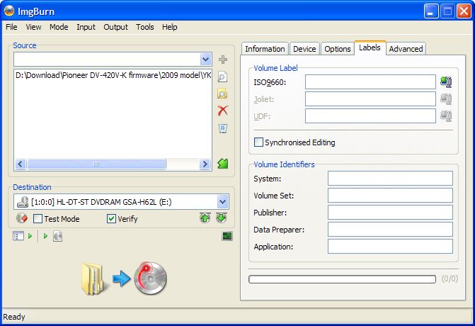

    5. Click on the Labels tab.
    In the Volume Label section, type PIONEER in the ISO9660 box. Remember, all in capital letters.

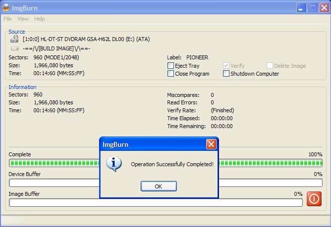

    ImgBurn burns the file and verifies the disc.
    Once the process is complete, "Operation Successfully Completed!" message appears.
