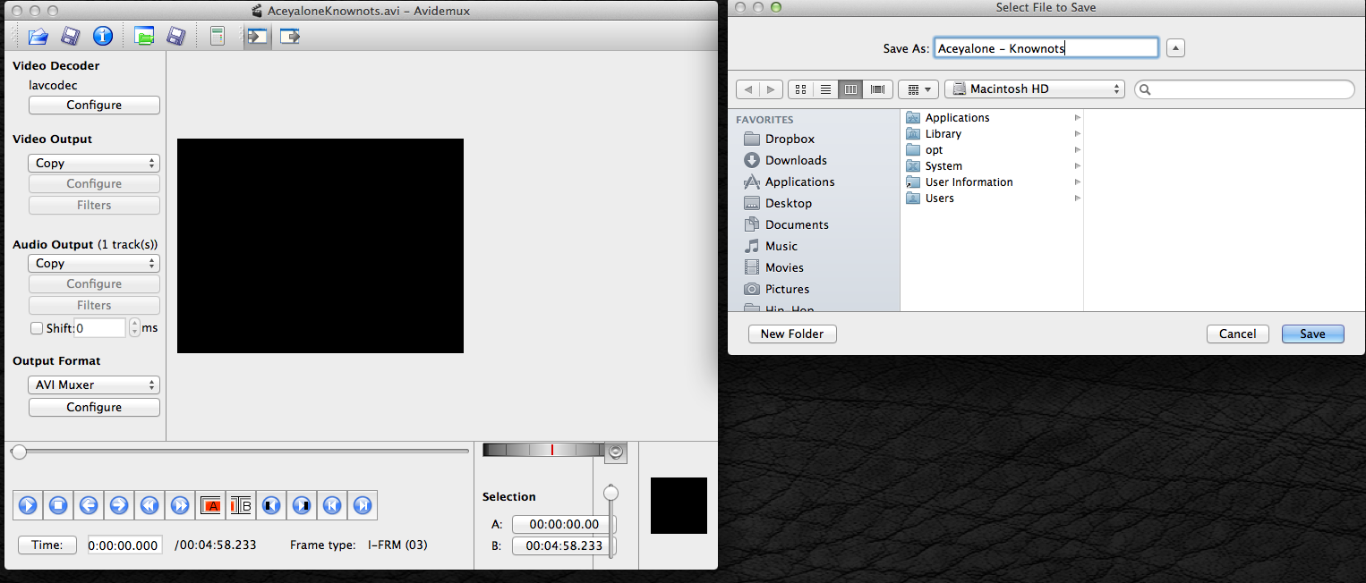

    Thanks for the clarification AlanHK, as the most recent reply I jumped to conclusions there. I definitely don't want to re-encode and lose quality. So basically run it through Avidemux, don't touch any of the settings and simply save. Is this done correctly? If audio is slightly off sync (most likely it's the source video as well) is there anything I can do to fix it?
    If the delay is constant, click the "shift" box under the Audio settings and enter the number of ms.
    MediaPlayer Classic is good for working out sync.
    Play it and press the + and - keys to get it synced, note the amount and then use that in Avidemux.
    But if the AVI is really damaged, sync may jump in different places and it may be very hard to resync.

    Awesome, the bad thing for me though I'm on a Mac and Media Player Classic is Windows only. Is there a Mac alternative out there you know of in regards to determining audio sync? I searched google and theres a lot of angry people it's not available for OSX
