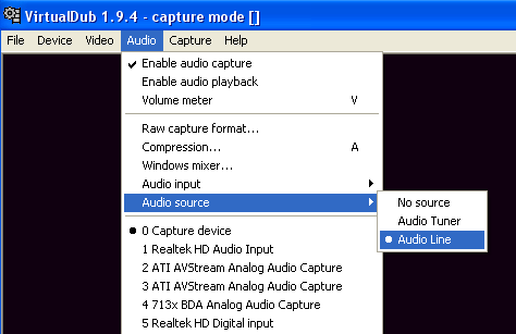

    ATI 650 has is own "sound card" (audio ADC). For composite and S-Video you must set from Audio menu: Capture device and Audio source>>Audio line.
    Check at Capture Filter: Filters properties >Volume. Must be different from 0. 0 means muting.

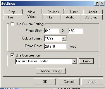

    This post show the right settings (PAL system) with VirtualDub: You must change the appropriate settings from PAL to NTSC (FPS 29.97, Size 720x480)

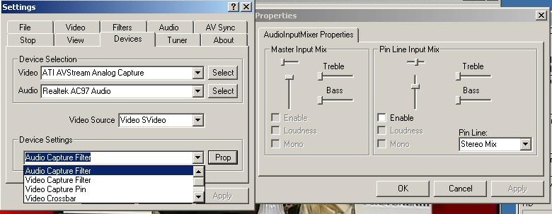

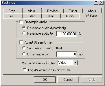

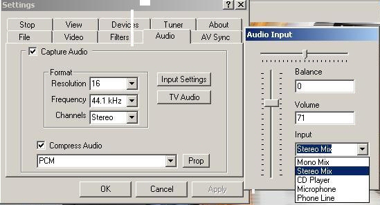

    I'm having a little trouble understanding exactly what you intended,when you said to check the capture filter I assume you meant the audio capture filter under the devices setting. I'm including a snap shot of that screen and although the picture doesn't show it I did try it with it enabled. The Pin line selection does not include an audio line to select. I've also included the two "audio" setting tabs.
    This is truely a case of being stuborn, I could probably get the desired results by bypassing the capture card and using the Microphone input for audio (haven't tried it). anothe option is VirtualDub but I haven't managed to get sound and video in sync there.
    This doesn't make any sense but virtual VCR appears to have a better picture than virtual dub and the ATI software which I use as an excuse for chasing the problem.
    Thanks again for your suggestions.

    Join Date: Jan 2010
    Location: United States
    the second one
    Join Date: Jan 2010
    and the final one

    Virtual VCR don`t recognize the "sound card" built-in ATI. Therefore you don`t have sound. Use VirtualDub and follows my recommendations from the first post.

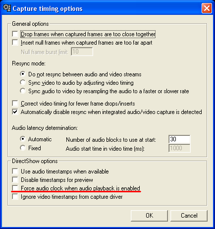

    Use ATI audio input, not microphone. Because ATI 650 has his own Audio ADC (analog digital converter) and the sound is always synch with video you must pay attention at these settings (VirtualDub):
    At Capture tick only > Timing > Do not resync between audio and video stream
    Automatically disable resync when integrated audio / video capture is detected

    At Audio tick these:
    Enable audio capture
    Volume meter
    Don`t tick Enable Audio Playback during capture because you get dropped frames
    Capture Device
    Source Audio> Audio Line

    I think you have something wrong with the recommended settings. I have the same issue when:
    Enable Audio Playback is set on and in the same time with "Force audio clock when audio playback is enabled"
    To fix dropped frames disable Enable Audio Playback or "Force audio clock when audio playback is enabled"
