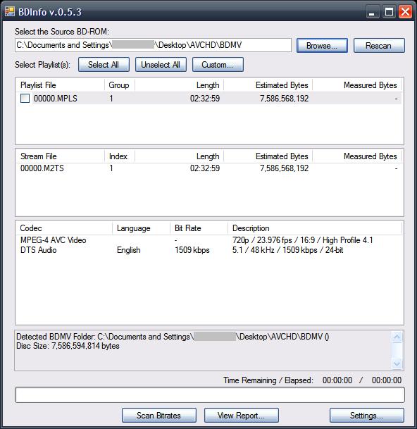

    BDInfo wouldn't load the disc, but I was able to load the BDMV folder from before the burn.
