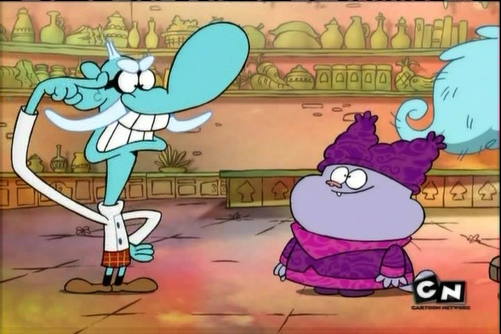

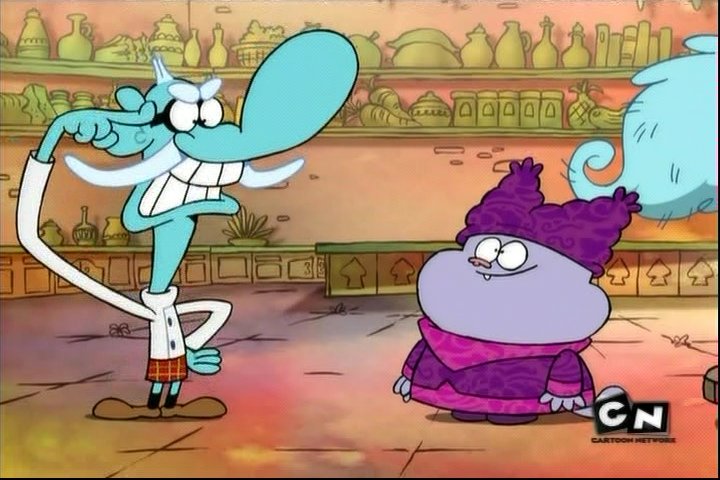

    - The Philips recorder has great video quality, but has some darker lines that I have written a script which hides them. Here is an example. Notice at the bottom, several darker horizontal lines. Also along the left edge and one line at the top.
    Here is the fixed image.
    FWIW, I think it's my tuner that makes those lines darker, not the Philips recorder. But I deal with them because I see them when I view it on my TV. I realize they are in the "overscan" area, but it appears that the new LCD HDTV's show the whole frame without cropping. At least mine seems to.
