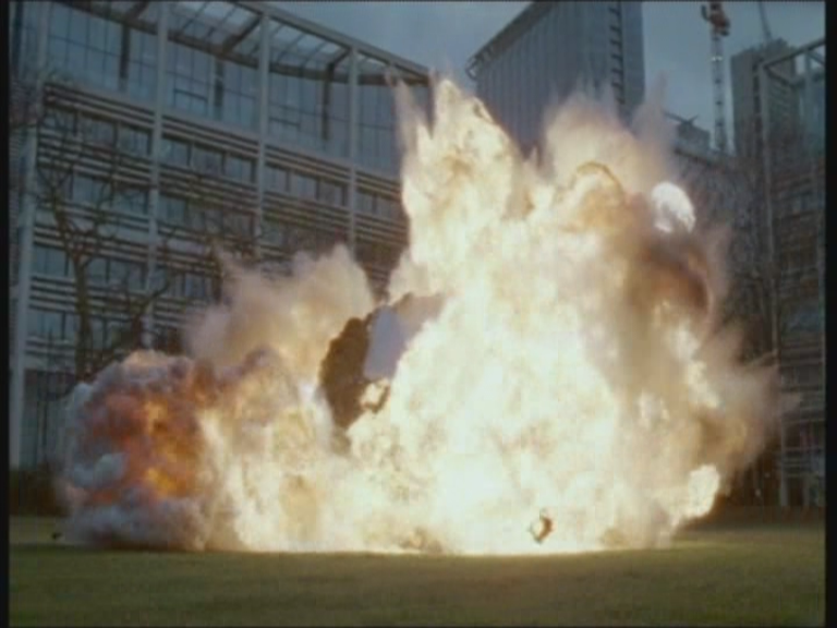

    The snap I posted earlier didn't turn out correctly so I am trying a different one.
    Thanks again.
    The Artful Dodger

    Yup, that found the problem. For some reason, yet to be determined, the downstairs Recorder is putting 4:3 despite the file being 16:9. But my work around involves PgcDemux, ReStream, and MuxMan.
