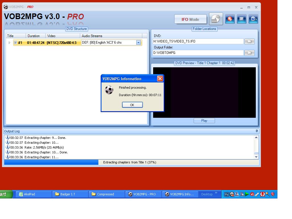

    I updated the installation from 3.0.0100 to version 3.0.0120 and now when I am converting a DVD it stops at about 50% (eg, if there are 26 chapters it always stops after chapter 13) of the way through and says complete. If I uninstall 3.0.0120 and reinstall 3.0.0100 I have no troubles at all. I have tried 2 different DVDs with both versions and everytime I get the same result. I guess I will stick to version 3.0.0100 until this is fixed up.

    Can you post the log from both versions on the same DVD please?

    I have attached what the logs have in them. It just appears that in version 3.0.0120 it stops half way through with no apparent error...

    Another interesting bit of information. I am only having this issue with 3.0.0120 when running directly from a DVD and using AnyDVD. It seems the performance updates in 3.0.0120 doesn't play nice with AnyDVD, whereas 3.0.0100 works everytime with AnyDVD.

    I can not process a ripped dvd with the latest version. I never had a problem with the previous. I found an unregistered previous copy and it process the rip with no problem. It is a single chapter (I only ripped the main movie). Any other information needed to help solve this problem please let me know and I will provide it.
    In my case Ican get only 37% done, See logs below 3.0.0.100 first then 3.0.0.120

    00:31:38 Start position: 893618176 End position: 970438656
    00:31:49 Rate: 6.63MB/s (53.06Mb/s)
    00:31:49 Extracting chapter: 8... Done.
    00:31:49 Extracting chapter: 9...
    00:31:49 Start position: 970438656 End position: 1098907648
    00:32:37 Rate: 2.54MB/s (20.34Mb/s)
    00:32:37 Extracting chapter: 9... Done.
    00:32:37 Extracting chapter: 10...
    00:32:37 Start position: 1098907648 End position: 1254328320
    00:33:35 Rate: 2.56MB/s (20.46Mb/s)
    00:33:35 Extracting chapter: 10... Done.
    00:33:35 Extracting chapter: 11...
    00:33:35 Start position: 1254328320 End position: 1281718272
    00:34:02 Start position: 1281718272 End position: 1463232512

    Yes I have. This issue and the "AnyDVD" issue posted originally are now resolved in 3.0.122. Please redownload and confirm if you will.
    Thanks again for uploading the DVD for analysis.
