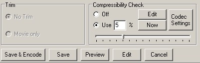

  12. You open the D2V and get a picture of the video. Then you do your cropping and resizing, choose the final size and the audio bitrate. Click 'Save And Encode' in the bottom left of the picture and you'll see:
    Then make yours like the picture, with 5% ticked in the compress test box. Then hit the 'Save And Encode' button, do some other stuff in the Encoding Control Panel to which it'll send you, 'Add Job To Encoding Queue', and 'Start Encoding'. You should get a vdenc.log which when loaded should get you a compress test percentage.

    If you set it up to do the compress test (tick the 5% box), then all it encodes is the 5%. You'll do the main encode of the entire movie separately, perhaps after adjusting the resolution and/or the final size. If you take a look at the .avs created for the compress test, near the bottom you'll see this:
    #  COMPRESSIBILITY CHECK
    #  !!!!Snip Size now has to be 14 for use in GKnot!
    SelectRangeEvery(280,14)
    That says to encode 14 frames out of every 280 frames.
