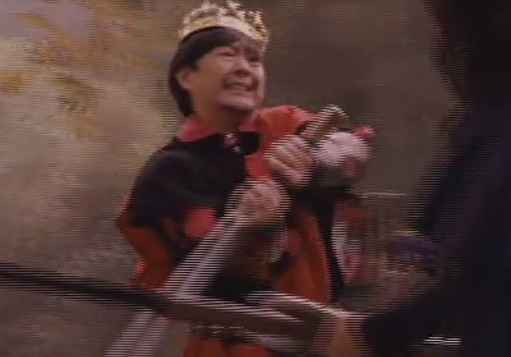

    Here's a screen shot. I haven't changed the way I convert between the versions.

    You simply have interalced video. Either deinterlace before encoding or use a deinterlacer (and don't resize the video before encoding) during playback.
    With interlaced video each frame contains two half pictures, or fields, intended to be viewed one at a time, not both at the same time.

    Has divx changed how they deal with interlaced video? I haven't changed either the way I decrypt or encode?

    I presumed this was an interlacing issue, but I just thought it was a bit odd that a process that was fairly reliable (if not the highest quality) had changed between versions.
    Maybe your previous videos weren't interlaced?
