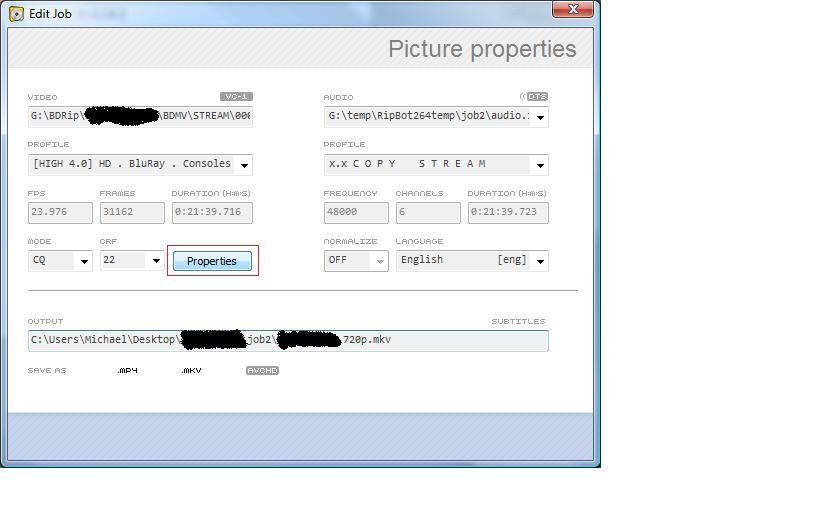

    I agree with Baldrick - Ripbot264 should be able to do what you're looking for. I have written a guide here on how to convert a Blu Ray rip into a .mkv file. If multiple audio tracks and/or subtitles are important to you, this guide can help you with those but if not, you can ignore those sections. One note on reducing size from 1920 to 1280, I have recently found out that Ripbot264 does this very well.

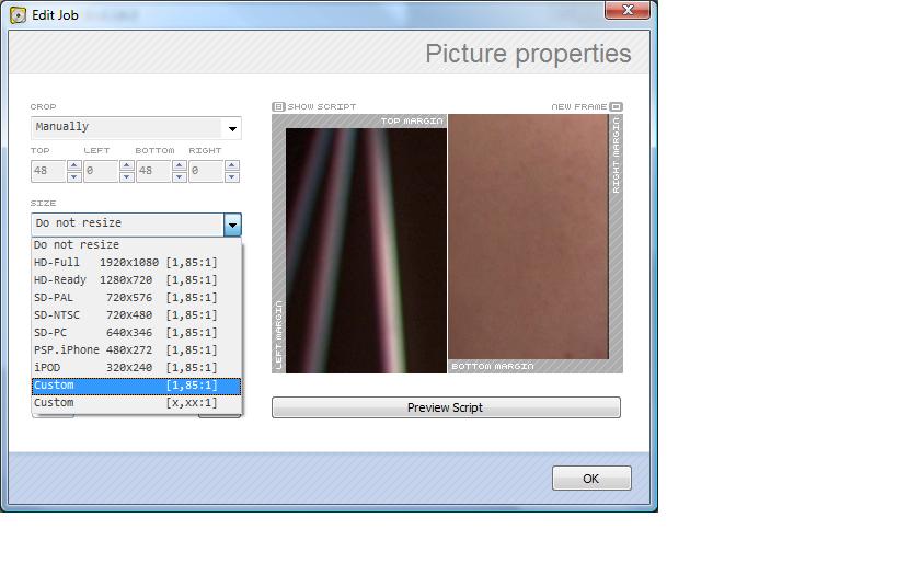

    If you do not need to crop your input video (either because it does not have any black bars or because you want to keep those black bars) then you can simply select "HD-Ready 1280X720" from the resize dropdown menu.

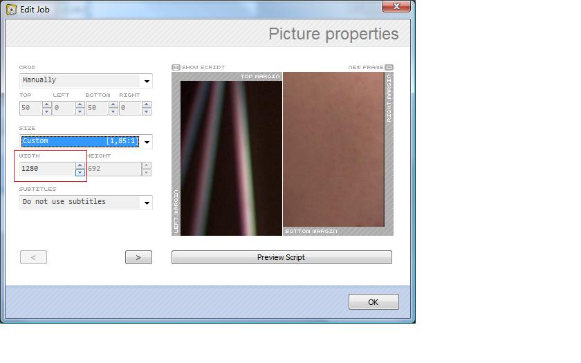

    However, if you do want to crop off black bars you must set a custom size otherwise your output file will have black bars to make it 1280X720. If you set the Width to 1280, it will automatically scale the height to whatever is needed to remove any black bars.
