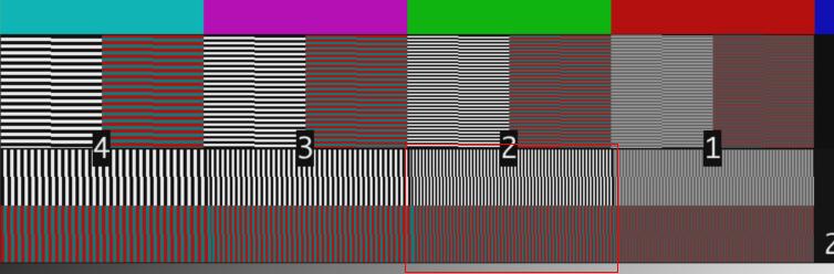

    OK, so this is related to the WDTV1 and version 2.
    Jagabo made this post http://forum.videohelp.com/topic374280.html#2014773
    It got me wandering, so I downloaded all the pictures. I did this to mainly test my WD Live TV via component.
    I have a older HDTV (42" plasma) with only composite, component, and DVI inputs. It does 720p and 1080i.
    If you look at the test pics, you will know what i'm talking about (hopefully).

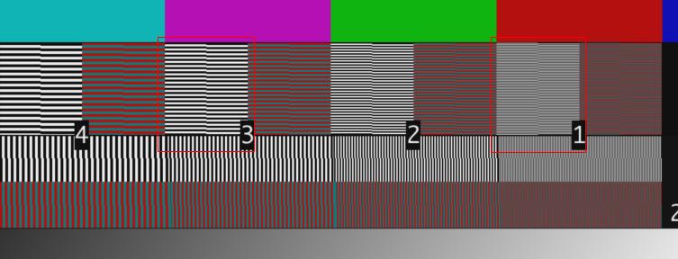

    If I load the testchart.tiff with my WDTV set to 1080i (YUV or RGB doesn't matter), the red boxed areas look like they are blinking on the TV
    Now if I set the WDTV to 720p (YUV or RGB doesn't matter), the blinking has stopped. However, the red boxed area is very blury and smuged
    So my question is why?
    All the colors look right and the gray scale looks perfect too.
    I haven't tested it via DVI, because I will never have the WDTV hooked up this way.

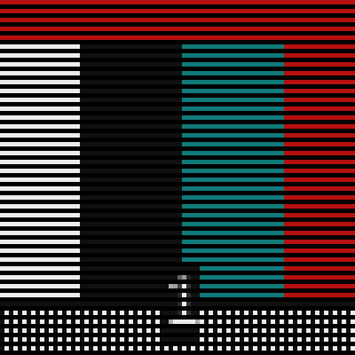

    When you feed the test image to your HDTV as 1080i it arrives at the TV as an interlaced image. The proper way to view an interlaced image is one field at a time. In the areas with thin horizontal lines you have one field that is black and one field that is white. When viewed on an interlaced display it would be flashing black and white! Your TV is doing the best it can to duplicate this. Here's a 4x nearest neighbor enlargement of what a "perfect" interlaced display would show you (slowed down to 2 fields per second rather than 60 fields per second):

    My pics above are just print screens of the original. They are in no way representitive of what they actually look like on my TV. I just needed something to represent which fields I was refereing too.
    Even though my TV will accept 720p, it native resolution is 1080i, so it scales everything to that. The 720p test pict didn't look as good.
    I'm curious as to why fields 4 and 2 were not flickering, does it have to do with the size of the lines?
    Also, if I take the original tiff files, tat are compressed, MAC color space and change them to uncompressed interlaced jpg, would it produce the same results? Not sure if bmp can be set as interlaced
    They should have been flickering a little bit (looked like they were bouncing up and down by one scan line). But yes, the reduced flickering has to do with the thickness of the horizontal lines.

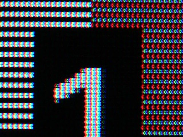

    The manual doesn't indicate the native resolution of the panel. There weren't many plasmas back in 2005 that had 1920x1080 native resolution. A little Google searching indicates the native resolution of that set is 1024x768. And the plasma panel is progressive, not interlaced. If your TV has 1920x1080 resolution with pixel-for-pixel mapping you should be able to see each of the black and white lines in the "1" area. As mentioned earlier, when fed as an interlaced signal the horizontal lines may not resolve and will flicker because of the deinterlacing.
    Here's an extreme close-up snapshot of my TV displaying the 1920x1080 Belle Nuit pattern:
    That's the top of the "1". You can see the alternating black and white lines on the left, the alternating red and cyan lines on the right.
