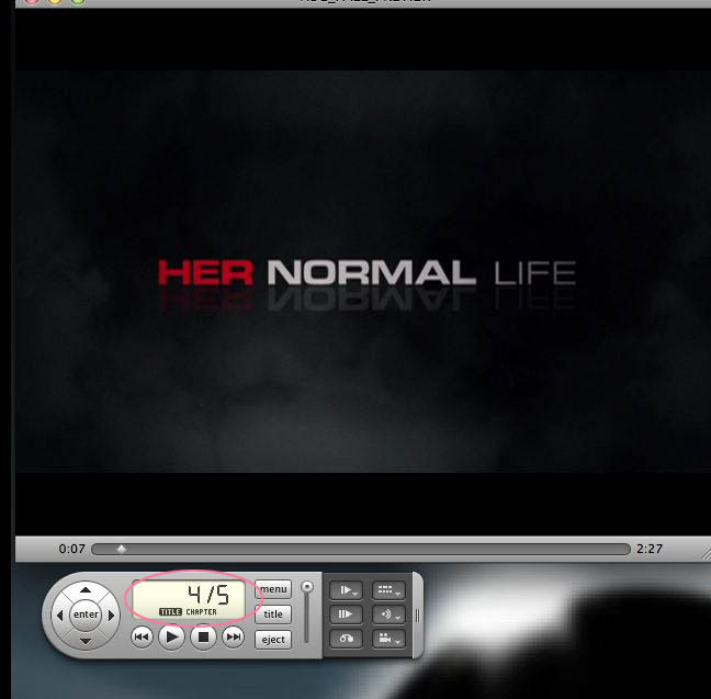

    when i play the dvd my mac, where do i have to go to see the title number (as you indicate)? it seems i just see the #s as they would appear on a standard dvd player...

  12. Member terryj's Avatar
    Join Date: Sep 2002
    Location: N35°25.24068, W097°34.204
    Originally Posted by mulgui
    thanks for the tips.
    so:
    From Apple DVD Player Help:
    Select either Title or Chapter, then click the time display to show elapsed playback time, time remaining,
    or the number of the current title or chapter.

    it works!!! you are brilliant!!!
    thanks so much for your patience and time!!! it is very much appreciated!
