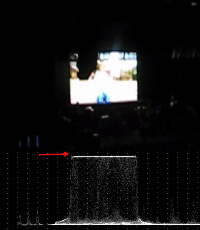

    Thanks for the help. Here is a 51 second portion of the concert video. Anything look doable? I would love to get this to work ... it was the coolest thing. Thank you! http://www.mediafire.com/?2jzi1njtyiz

    I tried on two programs but there is no image, your camera overexposed the video by opening the aperture too much.

    There is no hope of restoring anything in the brighter regions of that WMV file. Is that right out of your camera? Assuming no, there might still be some possibility of squeezing a little more detail out of the original source. What type of file is it? Open it with GSpot and post the information it gives you on container and video codec.
    The graph in the above image shows the luma (brightness) channel. The red arrow points to where a conversion might have lost some detail (it's common that peak brightness would be clamped above luma=235 during a conversion, whereas luma can extend up to 255).

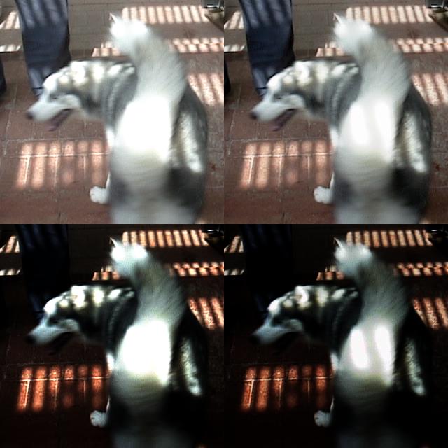

    Note: even if there is more detail it will only be a little bit. Here's an example:
    The top left is what you would normally see on a computer screen. The top right is closer to what's actually in the original file. As you can see there is a little detail in the over-exposed tail, but it is normally washed out when displayed, and sometimes when converting (depending on the software used). The two lower two images are modified to enhance details in the bright tail (ignoring other parts of the image). Note that the lower left image does not show any detail in the over-exposed tail. The right image shows some detail although some areas are still washed out (it was irretrievably lost by the camcorder).
    Video usually uses the YUV colorspace in which a brightness of 16 is full black, and 235 is full bright. The values from 0-16 and 235-255 are not supposed to be used, but sometimes are. When this is converted to RGB for display on a computer monitor, the range from 16-235 is expanded to 0-255 -- because on computers 0 is full black and 255 is full bright. If the YUV image has any detail below 16 it is all lost, ie, all pixels with a brightness from 0 to 16 all become 0. The same is true for any information above 235, all pixels with brightness from 235 to 255 all become 255. There is no chance of retrieving any of that over-dark and over-bright detail after this contrast expansion. If you can access the original YUV data you can get that detail back.
