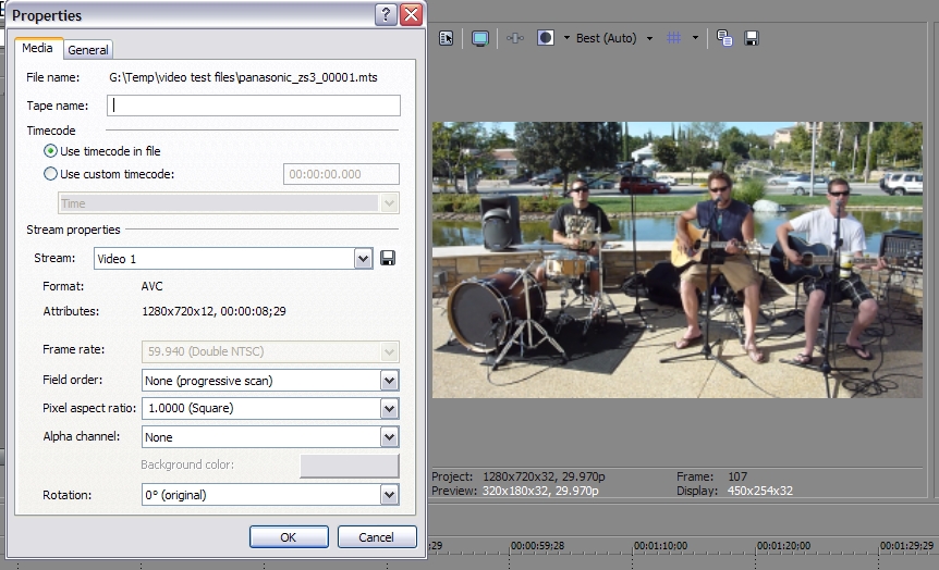

    it seems to really be 60p. vegas pro9 correctly identifies it and uses it.

    vegas uses it ok without disabling resample. i can export as 30p -no dupes or 60p with the dupes.

    If you examine your vegas encoded file you will see blended frames
    Vegas mistakes the file as 60p (like most software)
    The musicans are horizontally still, so it's not perfectly evident, but look at the cars in the background
    vegas
    http://tinypic.com/r/10fuecn/3
    ffms2
    http://tinypic.com/r/oa915u/3
    Other AVCHD lite cameras exhibit this same behaviour with vegas
    Cheers

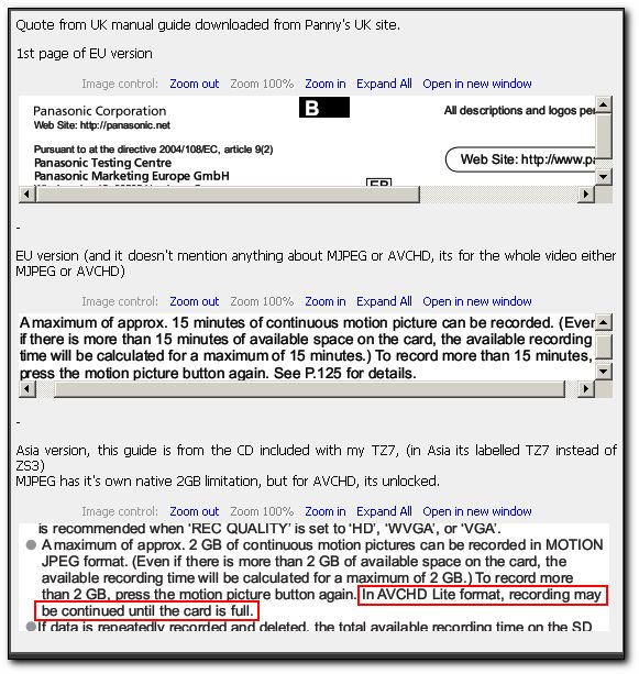

    The ZS3 was the only pocketable I could find with any vestige of manual controllability in video, and with the ability to record for longer than 30 minutes at a time...
    Is this true? I have a TZ7 which i believe is the UK version and that only does 15mins. Have i missed something?

    My ZS3 records continuously for as long as the battery lasts, or about 90 minutes of non-stop seamless high quality AVCHD-lite video.

    What an arse. It seems that non EU versions are indeed like that. Whereas we in the EU have the 15 min limit!!!!:

    and yet it's a 29m 59s limit on the FZ38 for that same EU tax reason.... looks like Panasonic could have made it longer than 15m
