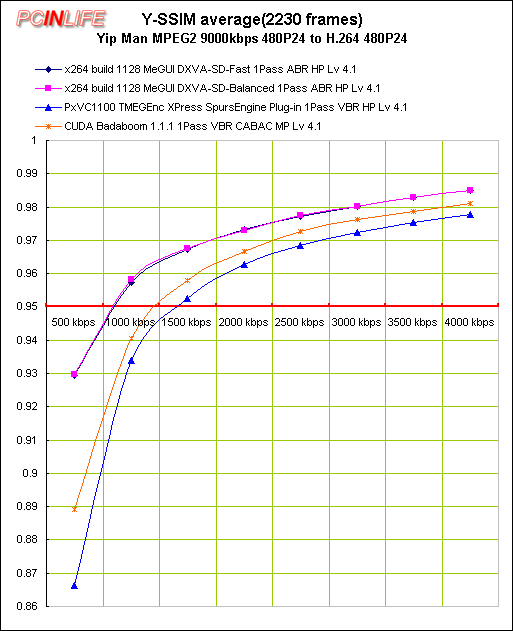

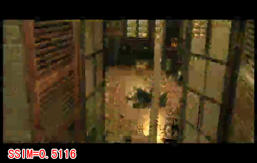

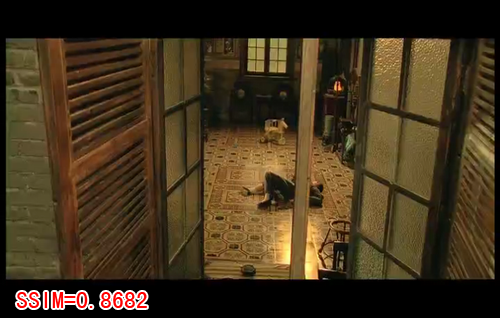

    If you look at the ssim graphs, basically it shows spurs engine is worse than badaboom which worse than x264...If you look at the review samples in that thread and others, the image quality is dreadful compared to x264 at any equivalent bitrate

    x264 500kbps
    spurs engine 500kbps
    ssim graph
    If you are looking for a compromise, (like using bigger file size or bitrate for the same quality - you need 30-70% larger filesize just to get equivalent quality), just to get it done a bit faster, this might be ok for you.
