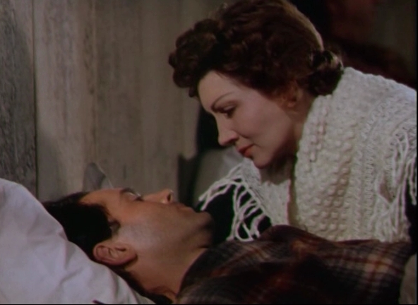

    Have a look at the bleeding I am talking about. Watch the woman's nose and the white cloth below her face.

    ChromaShift(c=-2)
    Join Date: May 2004
    Location: Brazil
    It looks better, Jagabo.

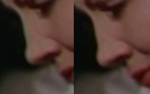

    Originally Posted by vhelp
    I could not see evidense of your issue from the pics that you and jagabo posted so far.
    Note how the green hue from the background has spilled over into the woman's nose (carlmart's jpg on the left, 4x nearest neighbor enlargement):
    And note how shifting the chroma channels 2 pixels to the left has fixed the problem (on the right).

    Note that my ChromaShift(c=-2) was just a quick hack. And All I really looked at was the woman's nose. It may be that the U and V channels need different amounts of shift and they may also need vertical shifts. I would look for sharp vertical and horizontal colored edges somewhere else in the video to figure out exactly how much adjustment is necessary.
    Also, with YV12 encoding (as is used on all DVDs) you will always get some color blurring because the chroma channels are encoded at half (each axis) resolution. For example a 720x480 video has the grayscale (luma) information encoded at 720x480 but the color information is encoded at 360x240.
