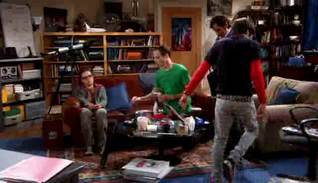

    I have ripped my movies into .avi files so they can be played in my Media Center. I usedg Auto GK to do this (from a DVD movie dycrypted using DVD Dycrypter).
    With some exceptions I was very happy with the results so I moved on to my TV Series DVDs. This is when a perplexing issues occured,
    I have followed the same process Iused for the feature films, but for some reason my 30min DVD rips are horrible quailty. I have tried three diffrent series of shows and they all come out blurry.
    My desied size is around 174mb, which I think is fair since similar sizes can be found on torrent sites. However to test things I have tried diffrent, larger files sizes and they too are blurry.
    Auo GK offers a percentage of quality which on my porgram is defaulted to 75%. I tried ripping at 100% and then again at 75% and my files sizes were around 1.5 gb and 1.2 gb respectivly. The quality was better but the file size is just absurd.
    Am I doing something wrong?
    Are TV series DVDs diffrent then feature film DVDs?
    Can someone suggest a means to get a decent quailty picture with a manageable file size?
    Below is a VLC snap of one of my samples.
  2. The pic is indicative of too low of a bitrate. However, if you want some better informed advice, please post the log from one of these encodes that turned out badly and maybe a 10 second sample of the source, a sample showing movement.
    However, if you're trying to compress a DVD source to 175 MB that gives a file size almost 7 times greater at 75% quality, then I don't really know how you'd expect anything decent to come out of it. Also, I suspect you're forcing a 640 width where AutoGK would have chosen one much less if you had left the width on auto. But we won't know the definitive answer to that one without the log.

    Your video bitrate is lower than your audio bitrate of 128kb/s
    You probably allocated 175MB for the whole DVD , not a single episode
  7. Yep, you encoded all the episodes at once. For episodic DVDs, decrypt the episodes separately, each to its own folder (DVD Decrypter in IFO Mode), and then encode them separately. So, you're not encoding a single 30 minute episode, but 2 hours worth of episodes (4 episodes per DVD?).
    [17/06/2009 10:34:00 PM] Predicted comptest value is: 5.60%
    That tells the whole story. It doesn't get much worse than that. And, as I speculated earlier, you're forcing a 640 width. That removes a lot of AutoGK's ability to encode with any sort of quality, even if you had managed to decrypt these episodes properly.

    Ripping each episode and storing them in seperate files did the trick.
    Thank you very much, now I can finally move on with my media center project.
