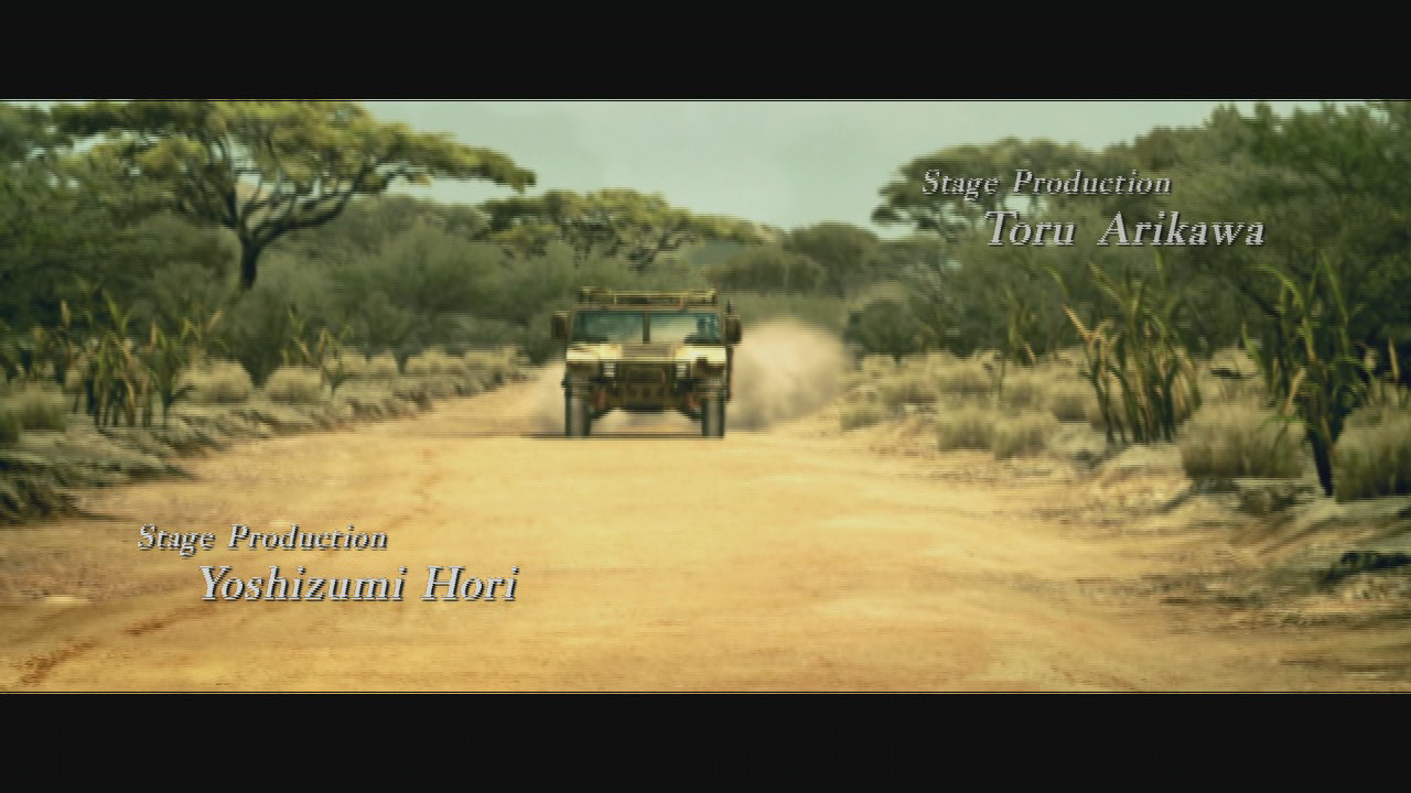

    everytime I try to capture something with the motion jpeg setting the result is not only out of synch, but wierd kind of interlaced. which is something 720p should absolutley not be right? I uploaded an example here:
    http://www.youtube.com/watch?v=OmcpGW-SmWY
    it's very obvious with text and other static things.
    why does the mjpeg codec swap fields? I dont get it. and where might I be able to change something like that?

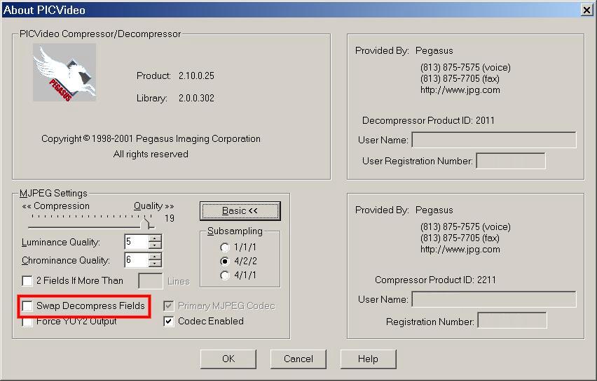

    I don't know which mjpeg encoder is being used to compress with the Intensity Pro, or what decoder is being used on the Mac, but here's the PicVideo mjpeg encoder config dialog under Windows:
    The Swap Decompress Fields option is the one you want to change. In this encoder the option only effects the way the video is treated on decompression.
    Note that this option is to correct for a bug in old Matrox video capture cards.

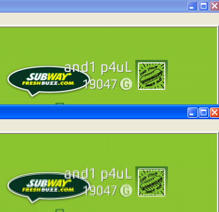

    I downloaded the file I uploaded -- just in case I uploaded the wrong one! It definitely displays differently than your original. A cropped screen cap of the two:
    Did you search your editor on the Mac for a field swap option? That would be the easiest way to fix this.
