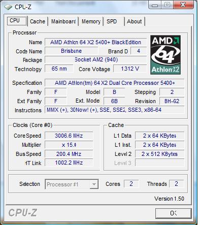

    DL a copy of CPU-Z and it will tell you what your present settings really are. http://www.cpuid.com/cpuz.php Here's one of my Brisbanes:
    Notice that the CPU speed is a product of the multiplier and the Bus speed. On my setup, for 3GHZ, I would raise the Bus speed to 222Mhz and that would give me 3Ghz. (Just divide 3000 by your multiplier and that will tell you what to set the Bus speed at.) You might also notice the high multiplier value. That tends to limit OCing the multiplier because you may raise the other values too much. Make sure your RAM is up to it and can handle a higher FSB. And make sure the RAM voltage is set correctly. A lot of the performance RAM is made for about 2.1VDC and most MBs set it automatically at 1.8VDC. CPU-Z will tell you all that.

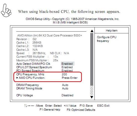

    That MB seems a bit limited for OCing. I saw this in the manual:
    And this is the only info for setting the FSB:

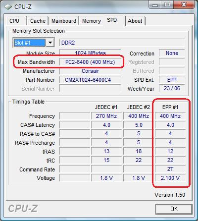

    You might post a screen shot of CPU-Z, the CPU first page and the Memory and SPD page. That would give a lot of info on your RAM and settings.

    It looks like your RAM is OK for 1.8VDC, which is usually default. So probably no change needed there.

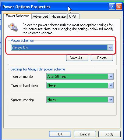

    If you are OCing, I would also turn off any MS power saving program, at least for now. There is one setting in Control Panel>Power Options in XP:

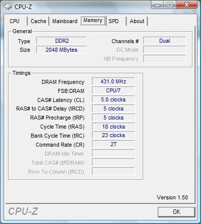

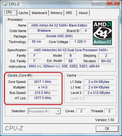

    Anyway, I raised the FSB to 215Mhz and it booted and runs fine. CPU temp about 22C at idle. My RAM is DDR2 800 and I couldn't raise the voltage to 2.1 with my MB, so it's performing OK, but could be better. You can see the EPP timings in the third JPG and that's where it should be. Notice that the RAM frequency has also went up, along with the HT. As long as the RAM can handle the frequency increase, no problems.
    I tried running the FSB to 230Mhz, but it wouldn't boot, so I gave up. With a different MB that would let me raise the RAM voltage and drop down the RAM frequency and maybe the HT frequency, it would probably run at 3.3Ghz or possibly higher. But I don't need it for that. It's going to be used for a graphics editor I will install two more GB of DDR2 800 RAM, though.
