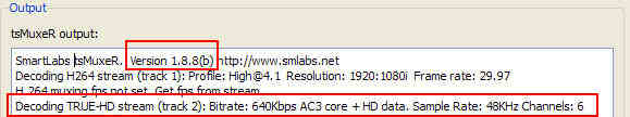

    Use the beta version 1.8.22 or later, there is a new one today 1.8.24
    Just convert your video (use search for the dozens of guides), and remux with the audio in later. Make sure you use .m2ts not .mkv, as it doesn't support THD

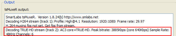

    Tried with a newest -yestardays version of ts muxer but still getting dts core-dts surround audio no HD.So tsmuxer not working for me.
    This is line from tsmuxer-Decoding DTS-HD stream (track 3): Bitrate: 1536Kbps DTS core + MLP data. Sample Rate: 48KHz
    Channels 6 it shows that there is HD audio but still retrieve only DTS CORE.It shows me that tsmuxer recognize HD audio but still retriewe only DTS core.

    You're probably using the wrong version. You need the beta - make sure you download from the beta link, not the regular link. It dumps more than just the core now. Atak has stated on the Doom9 thread that ripbot won't do this for a number of reasons (a big one being .mkv doesn't support THD)
    and using the old version

    May you send me screens of confuguration you made to het this HD audio being copied .Just tried latest version beta ,thats what im getting SmartLabs tsMuxeR. Version 1.8.24(b) http://www.smlabs.net
    VC-1 muxing fps not set. Get fps from stream.
    Decoding VC-1 stream (track 1): Profile: Advanced@3 Resolution: 1920:1080p Frame rate: 23.976
    Decoding DTS-HD stream (track 2): Bitrate: 1536Kbps DTS core + MLP data. Sample Rate: 48KHz Channels: 6

    Maybe there is a error/problem with your stream? Did you use recent AnyDVD HD ? I just used default configuration in the GUI, mux to .m2ts, no special configuration
