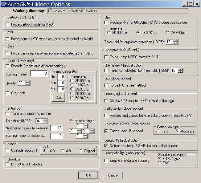

    Doesn't AutoGK allow some access to advanced Xvid options? Via F9 or Alt F9 or something like that?
    There are plenty of options, but not for the XviD settings he wants to adjust:
