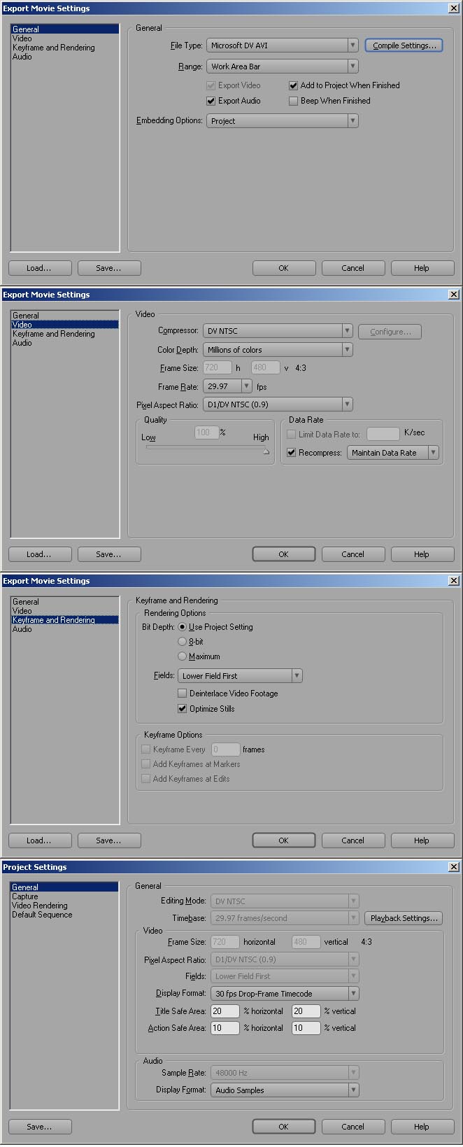

  17. Member Safesurfer's Avatar
    Join Date: Mar 2004
    Location: United States
    I did a quick search on the forum and found this image of the export settings for Premiere. I would be willing to bet that unchecking the Recompress check box in the Video settings would "Smart render" the DV and preserve the metadata except at transition points or where you've applied effects that require reencoding the video. It would be worth testing and could then remove the need for recreating metadata on exported clips.
    "Just another sheep boy, duck call, swan
    song, idiot son of donkey kong - Julian Cope"
  18. this is really great! but may i ask, can your software be able to do Optical Scene Detection? if not that fine, as i will use either Scenalyzer or MSU Scene Change Detector which that itself outputs a .CSV file which opens in Excel (which i do have infact )
    so techncically, if i have that file, with all the information where a scene starts and stops, could i take that into your software with the one large avi file, and thereofre it will know afterwards when recapturing where to split the files?
    as for Premiere Pro, i always uncheck the Recompress checkbox, because even though i didnt know it will preserve the metadata, i feared it will recompress the quality itself.
