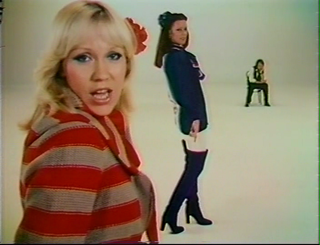

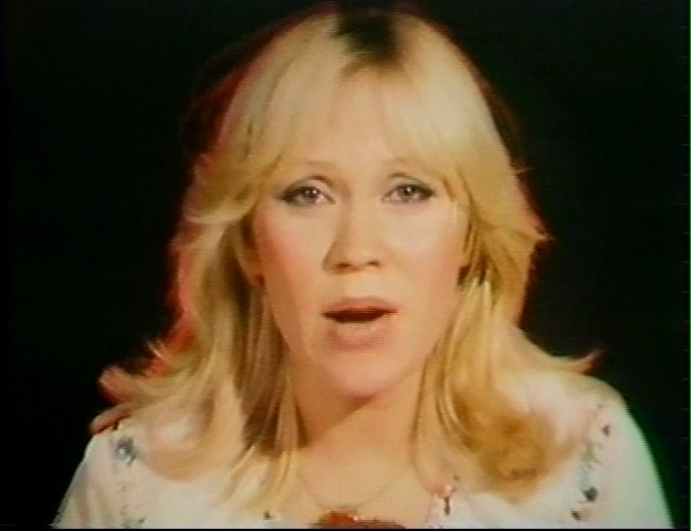

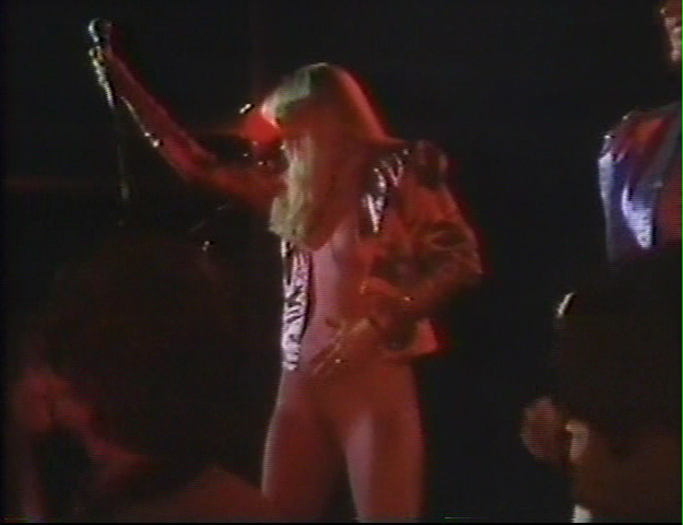

After watching Mamma Mia! on DVD ... I decided to dig out my ... Best of ABBA video Hits on VHS tape [they also were in the storage unit but deep inside some boxes] and transferred them to my Panasonic EH50 DVD Recorder ... a couple of days ago.
I first ran a VHS tape ... that I didn't care about ... a few times through the unit to warm it up and get any residue on the video head and capstan rollers off of it. I didn't open it up and clean it by hand.
The unit played just fine and the ABBA tapes were transferred with complete success to my Panasonic EH50.

Here are some images from the DVD I made of ABBA ... transferred from VHS tape to DVD
