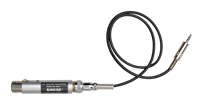

    You could get something like a Canon HV20/30 and shoot in DV mode. It has semi-pro external mic features. You just need a matching transformer to use XLR pro mics with long balanced cable runs.
    Shure A96F

    I wouldn't think the Shure mike plugs into my present camcorder. Are you suggesting some sort of transformer to connect it to the internal mike? For the Canon HV20/30?

    The Shure transformer allows use of long balanced low level mic cables and pro mics with a consumer level camcorder. The HV20 has been selling as low as $499. It has ability to switch off audio AGC so you can control mic level manually. Also has a peak audio meter in the viewfinder. Both are essential to good audio. It will also make far superior DV format pictures than your current cam.
    You would use the transformer with the HV20 or another camcorder with an external mic jack.
