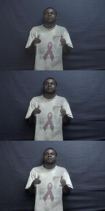

    That's a tough one. Here's a slight improvement I did with AviSynth:
    The top image is the original, the center is the the following adjustments in AviSynth:
    ColorYUV(off_y=-12)
    ColorYUV(cont_y=50)
    ColorYUV(gamma_y=85)
    The bottom image is this script:
    ColorYUV(cont_y=100)
    ColorYUV(gamma_y=100)
    All images were saved via VirtualDub so they have been through the usual rec601 contrast stretch for computer display.

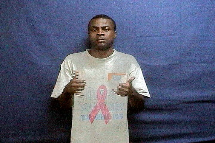

    I did this with MSU's color enhancement virtualdub filter, from here
    http://compression.ru/video/color_en.../index_en.html
    Obviously, it does introduce alot of noise, so that will have to be addressed.

    I added some smoothing and this is what the result looks like (see below). I used the following filter settings...
    What filter will help me get rid of the lines on the fingers?

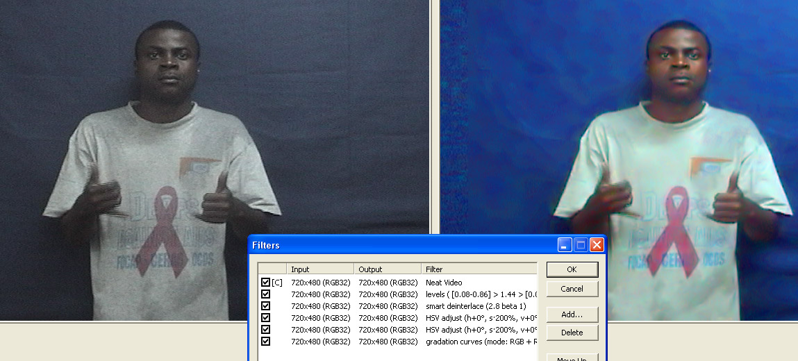

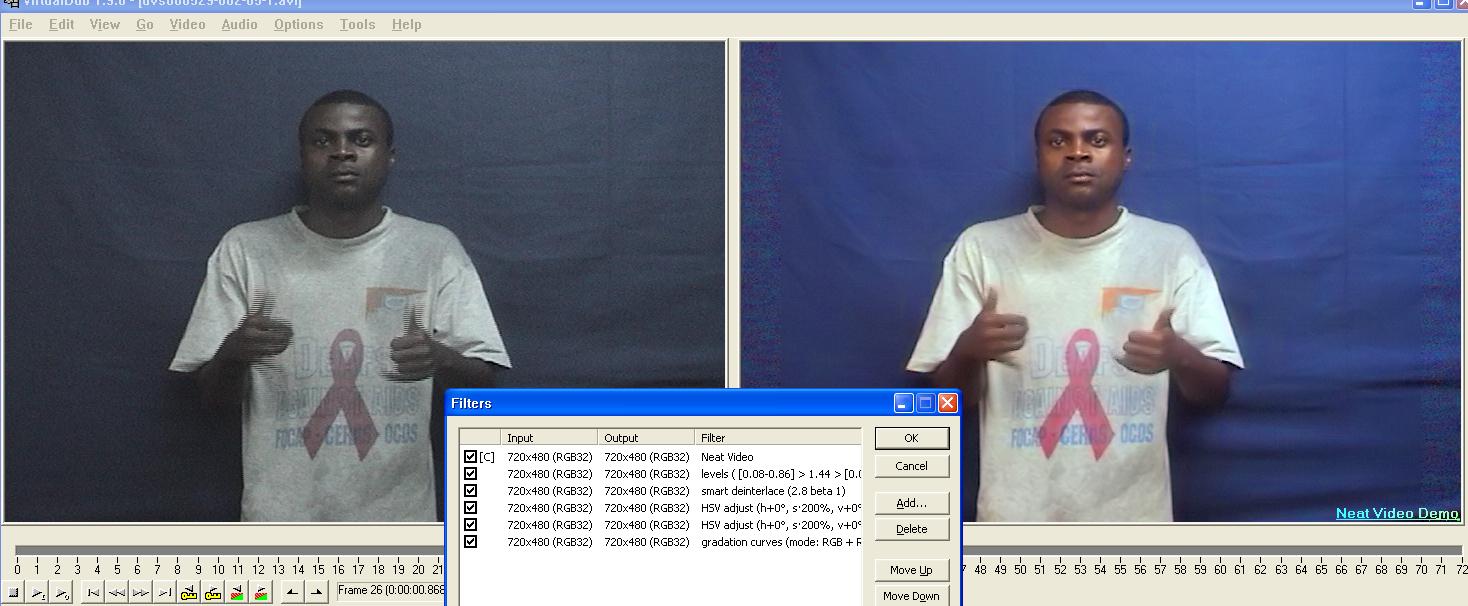

    Wow! Yours looks sooo great.
    Mine must be lacking on the Neat settings and/or Gradation Curve settings. I used the Filter and Sharpness preset for Neat and did not know what to set on gradation curves. Here's mine...

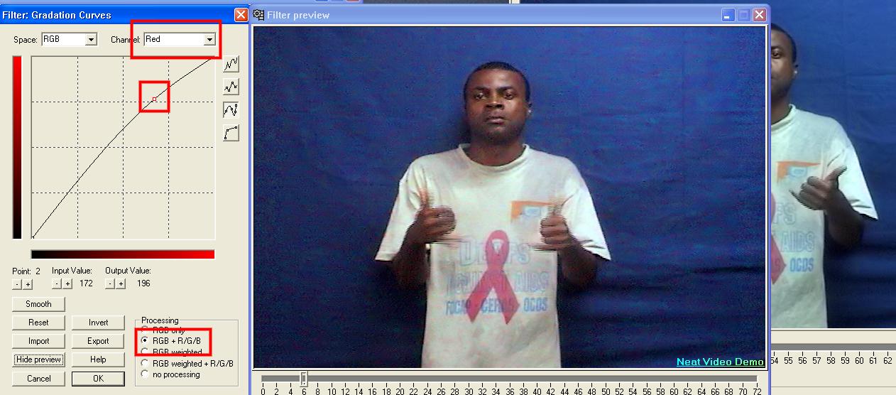

    I used Gradation Curves to correct the white balance. Assuming the t-shirt should have been grayish but appeared too green, I bumped up the red a little bit:

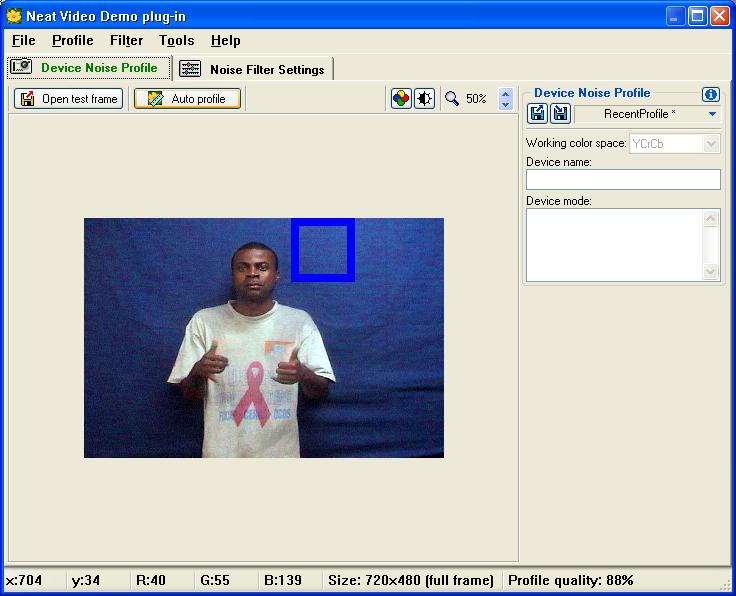

    Neat Video was configured by using the Auto Profiler. Move the box (or make a box by rubberbanding) on a "flat" section of the image and press Auto Profile. Neat Video will look at the noise in that area and use it as a guide for de-noising them image. You may find Neat Video works better at the end of the chain rather than the start (because the other filters in this example increase the noise).
